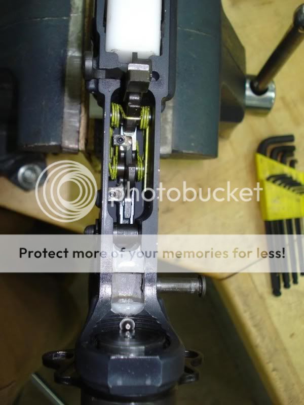

It is actually fairly common in some circles. Especially on AR-10s. The Upper is coated in release agent. The lower is scuffed below the rear upper lug. Epoxy is applied to the lower under the rear lug, and the halfs are assembled(with a nylon bolt if paranoid.
It looks like this when it is done:
I can't remember where I ripped the pic off from, and like I say, I can't say I see that it solves much.
