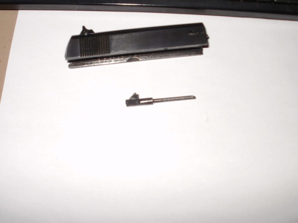

I have been having some issues with light firing pin strikes in the last few months on my Norinco M93 Woodsman copy and things have progressively gotten worse up until my range trip last week when I noticed this after having trouble with many FTFs:
The firing pin is just kinda loose in there and I can move it freely back and forth by hand or even just by shaking it. Is this worth fixing or an easy fix? Not sure what would make the firing pin let go like that?:confused:

most likely the end of the firing pin probly broke off. you might be able to have it welded back up (or maybe some JB-weld) depending on exactly how/where it broke, or maybe a norinco dealer could order a new firing pin.
best bet would be to take it apart to see exactly whats wrong with it though, just make sure you follow the instructions when taking these apart. and be gentle with the slide becouse as i found out a couple times if you dislodge the recoil spring right beside the firing pin it is a pain in the @ss to get back in.

How many rounds have you put through it? I would agree that it sounds like the pin part of that piece has broken free from the rear section. It would probably be weldable with the right prep and then to grind it all back to the correct shape, just make sure it goes on strait first. Finish couldn't be any worse than you would normally find in a norc anyways.

Most likely if you field strip the pistol you will find that rear portion of the firing pin containing the 'wing' has broken off and is floating somewhere inside. Possibly still even inside the firing pin channel in the slide.
Possibly the light strikes were occurring during the slow process of that portion breaking off. The wing is what engages the firing pin block safety on the frame, though it also serves to limit forward motion of the firing pin. Now, the forward portion of the pin is floating in the firing pin channel, resulting in that odd condition that you photographed.
I'd try to get it warrantied by the retailer. Might be tough to find a replacement part on your own. I would not be confident about repairing it, but if you're handy there's nothing really to lose by trying. Just be sure to take pics of the broken part before doing so in case it can be warrantied.

I took the slide apart and its definately a broken firing pin.
I guess I'll try and get a new firing pin or make an attempt at fixing this one.

Did you dry fire the pistol on an empty chamber? A lot of older .22 LR firearms don't like being dry fired as the firing pin can whack the edge of the chamber and sometimes break. I keep snap caps in my M93.
