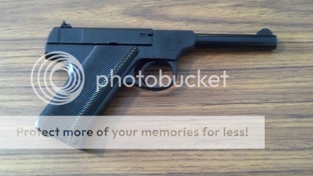

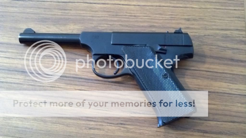

Norinco M93 = Never Been So Impressed = Go Buy One!!!!!
