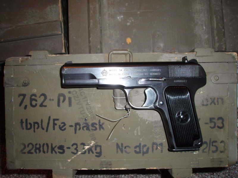

I was going to post a good picture of my Tokarev but it is too bloody frustrating. I don't know how others do it but it seems convoluted. Why the roundabout way of posting an image? Screw that. Words will have to suffice.

Ok just came into the light and with a bit of fiddling around finally was able to get an image of my Tokarev on top af a few boxes of ammo. Enjoy the photograph.
Bugger, it didn't work. I can see the photobucket URL on the reply before I save it. Afterwards it disappears. Must be Voodoo.
Safe Tok
Six Star said:
Hmm...no AWFUL thumb safety. I haven't seen a Norinco T54 before without one. Very nice!:)
Mine doesn't have one either. Ordered from Marstar a year and a bit ago. Type 54, as opposed to Type 54-1 (w/safety) I believe.
