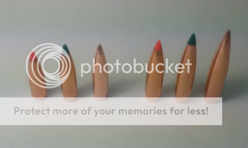

Thought I would add some pics to this thread
I was reading over at snipershide and the guys testing the 6mm said that the G7 was more like .290. Cant wait to get some downrange.
And a little comparison to some other bullets (cell pics)
22cal 53 Vmax, 69 TMK"s & 70 Noslers 6mm 87Vmax, 95TMK's & nosler 105's
