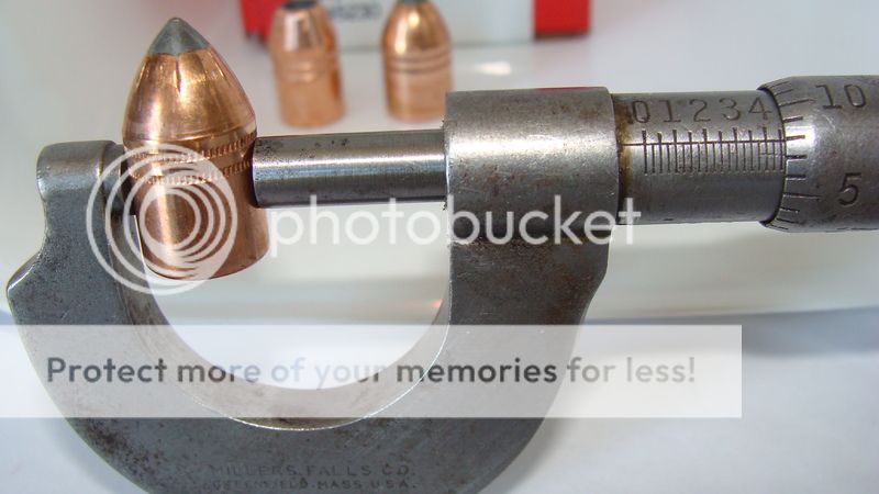

I use these bullets primarily for muzzleloading in a sabotless application. They will work in 45/70 also.

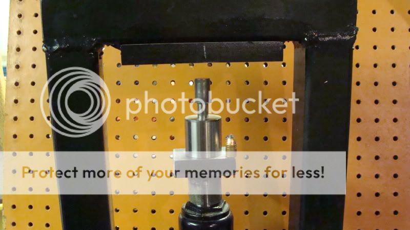

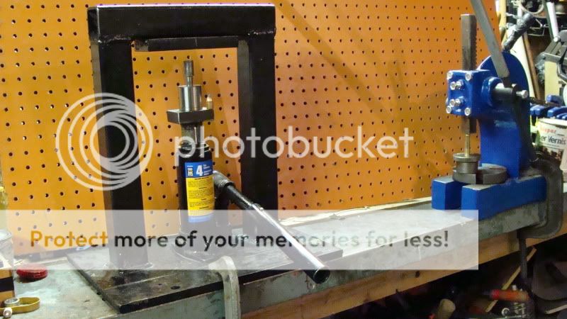

I got a new set of forming dies , It'll be used to reform and size to .458 diameter to work with my Full Forming die.

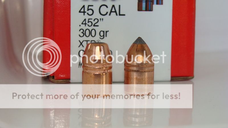

I reformed 300 gr. XTP's and bumped them up from .452 to .458 diameter. It'll do everything but solid coppers.
