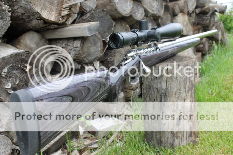

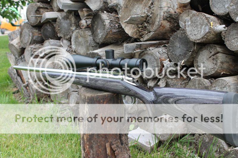

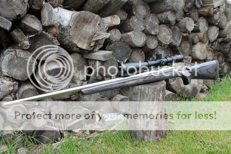

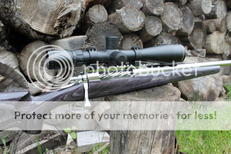

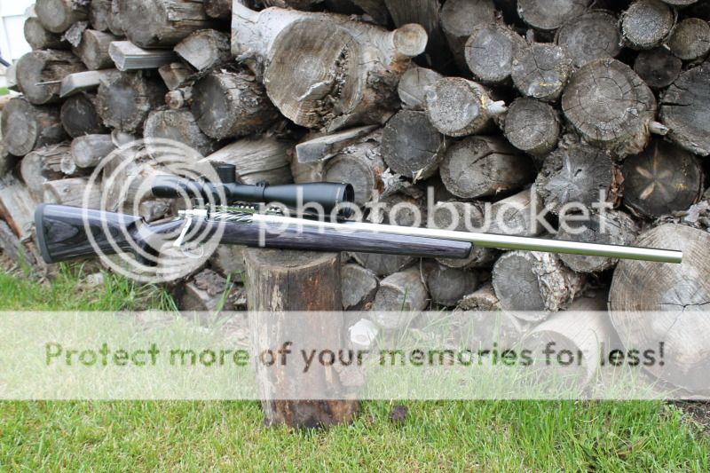

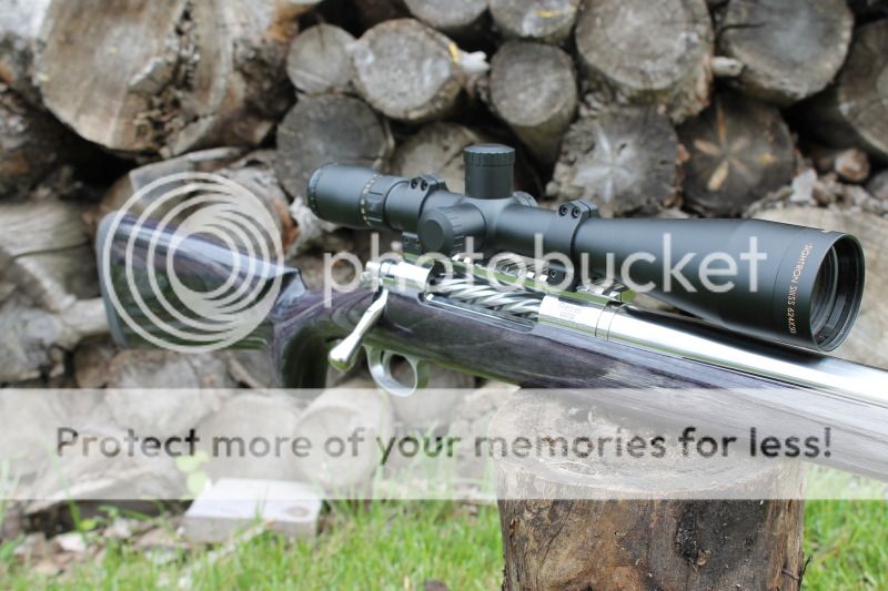

-Range 225yds (would have liked to be out at 300yds but it rained for 2 weeks and their is a bog there)
- 6.5-06 throated long for 140gr match bullets. 3.415 COL .005 off the lands. (These loads are safe in my gun but well over max suggested loads. DO NOT USE.)
- 270 win cases fire formed, annealed then neck sized.
-cci br2 primers
-H4831sc
-142gr smk
-overcast day, no mirage, 15 C, wind from behind me at about 10 mph
Adjusted my scope down and left after the 49gr group.Took me a while to settle in nice behind the rifle but it all came together just at the right time. Looks like I found a nice node around 51.4-51.7. Will try these two charges out further and see how that goes.
