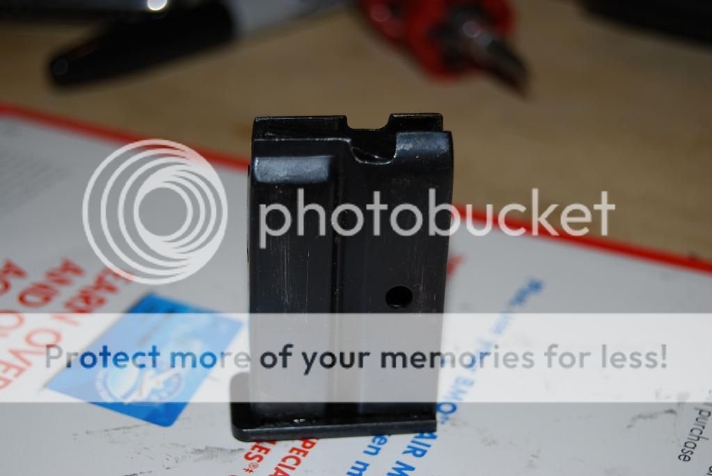

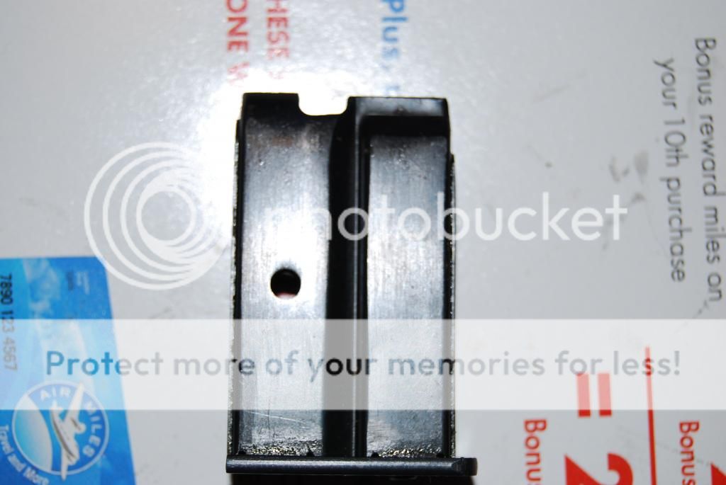

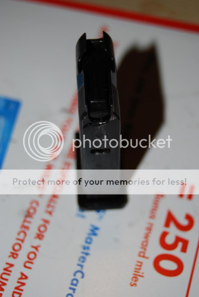

Post some pics of the mag... Profile, feed lips, etc... Maybe someone will recognize something familiar.

We're looking at very minor differences in size and angle being important here. To help us help you post a really good side on picture of the stock mag so we can see the angle and the configuration of the lips. At the same time use a set of calipers to measure the width and length of the magazine opening in the action. I say check the mag well because often the wells are overly loose and sloppy. So giving us both the mag well dimensions as well as the magazine dimensions would help a lot.
Pictures of the magazine retention system along with pointing out the notches or whatever the mags have for catches is also needed.

The magazines look simple enought. Sombody with a brake could likely shoot off a few. Here are some measurements.
Magazine
length: 1.169 =1.173
Width: .457 - .465
Height: 1.954 -1.983
The catch is a slotted hole .236 wide by .087 tall sitting .75 from the top of the mag.
Looks to me that the carrier determines the feed angle on this system. Don't have a protractor at hand but eyeballs would say it anywhere between 15 - 25 degrees.
