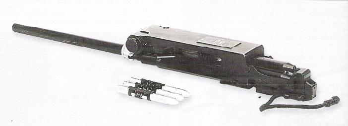

Nudelman Rikhter R-23cannon - perfect for shooting into space!

Revolver cannon AA Richter
The first and the only weapons in the USSR adopted an air gun turret type 23 mm cannon was the R-23, developed in OKB-16 under the leadership AARichtera.
R-23 (factory index 261P) destined for defensive weaponry bombers and its design scheme ensured a minimum effect on air flow mainly cannon tower in the transverse position. Therefore, the total length of the cannon made equal to the length of the barrel. Cartridge chamber are separated from the grooved part and mainly related to the block, which rotates about an axis parallel to the axis of the barrel. Use of such a unit allowed to place the ammunition belt from one of the cartridge chamber without there impede the barrel, making retraction of its charge (Translate text - page 102) by printing directly from the strip into the cartridge chamber in the direction opposite the direction of firing and ejection of cartridges in the direction of shooting. Total length of the weapon in such a way became equal to the length of the grooved barrel, cartridge chamber and electric evaporation system.
Flow diagram reflect such interaction mechanisms with the gun belt by charge, charge and firing the cartridge, which ensures comparable simplicity of its design, production, training and use. This is achieved using three autonomous gas engines operating (Translate text - page 103) immediately to the ammunition belt, charge and spent cartridges.
In so doing, the piston engine and ammunition belt moved transversely to the axis of the barrel, and block the cartridge chamber is rotated in a plane parallel to the axis of the barrel, while eliminating the effects of vibrations pozdĺnych gun while shooting for action automatics.
Finally the V, with vertical running gusset and mechanical poloautomatkou (untranslatable word in brackets - <копирново> - copier??) Type.
Sealing contact mainly with drum cartridge chambers to reach the seal-insert assembly positioned at the entrance to the channel in particular, gasket is pressed against the cartridge chamber to block the shot of gas pressure in the direction opposite the direction of shooting.
Cannon in firing position was fixed at two points, while the front hub has been caught in rod shock absorbers. Automation has worked with through three autonomous gas engines.
This unique gun also had a unique hub. Length of cartridge (260 mm) is equal to the total length of charge, thus the whole shot is inside the cartridge.
- R-23/261P gun, or his version of R-23M or derived cannon 225P was tested also in space to space station Almaz/Saljut-3 in 1974 (for a small cannon known Richter R-23 is often referred to as NR-23 cannon )

In addition to reconnaissance equipment, Almaz was equipped with a unique 23mm Rikhter (factory index 261P or 225P) rapid-fire cannon mounted on the forward belly of the station.[citation needed] This revolver cannon was modified from the tail-gun of the Tu-22 bomber and was capable of a theoretical rate of fire of 1800-2000 (up to 2600) rounds per minute. Each 168 gram (ammo 23-OFZ-D-R ) or 173 gram (ammo 23-OFZ-G-R) projectile flew at a speed of 850 m/s relative to the station. The cannon had supply of 32 rounds and was tested at the end of the mission, when the station was operating in unmanned mode. To aim the cannon, which was on a fixed mounting, the entire station would be turned to face the threat.
Salyut 3/OPS-2 conducted a successful remote test firing with the station unmanned due to concerns over excessive vibration and noise.
OPS-4 was to have featured two rockets instead of the aircraft cannon, but this system has not been shown publicly and may have never been fully manufactured despite it being used experimentally.
I have heard that the cannon could not be fired crossways to the axis of the orbit of the station - if this was done, it was predicted that the shells would catch up to the station within 2 orbits! :p
The cannon had to be fired in line with the axis of orbit of the station. :p

They were fired in space - the last crew who manned the last Almaz satellite fired theirs remotely after leaving the spacecraft in order to return to earth. Apparently the cosmonaut who fired it stated they fired the entire ammo supply of 32 rounds in one burst.
