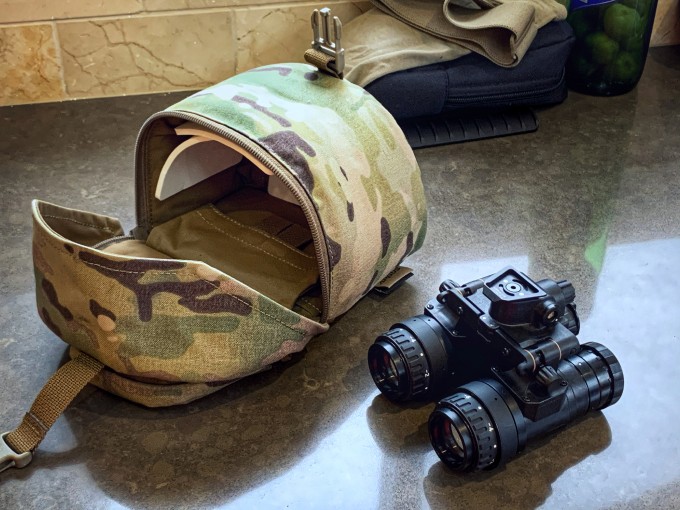

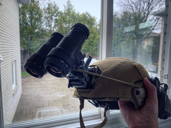

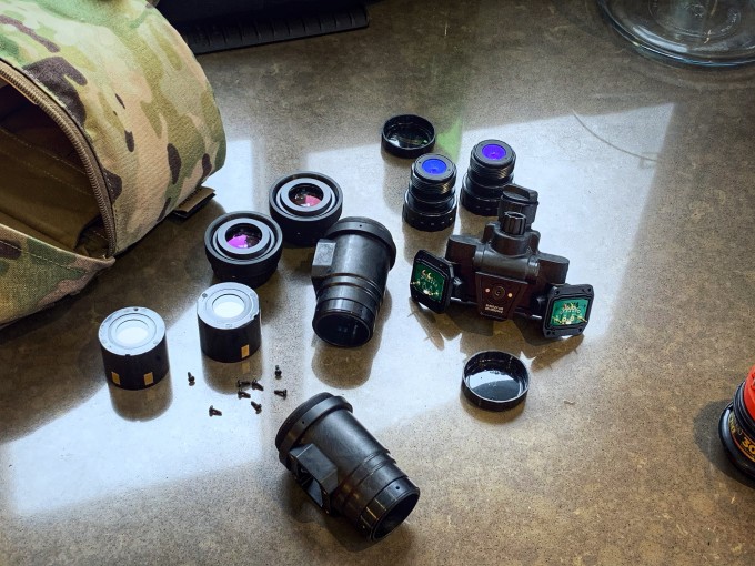

I've finally received my NVG kits yesterday. It's BNVD-1431, and I'm using 2 Photonis XR5 as my tubes. Total cost is $12280 CAD. I made the order from China using app called "Xianyu"(kind like kijiji) , the 1431 shipped from China due to this special time, I've waited for a month until it arrived..Photonis XR5 is Mil spec(FOM 1800+, 69lp/mm, SNR 27-30), it similar to American's Gen 3+ Omni6. it's shipped from Europe, come from Polish army's inventory...I can tell you now, the BNVD is a good case, it's amazing!Most important is...it's cheap than some web in Canada...
