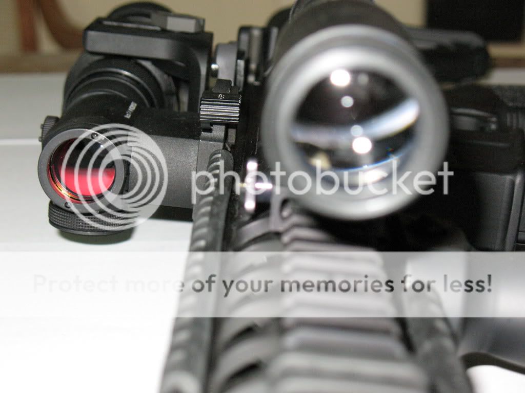

Da Torch IR illuminator
Mounts on side rail
AR christmas tree... makes it heavy enough to throw down a well. Shows various optics, NV, micro and others.
Once ya get something good its all about what kind of toys you can put on there.
