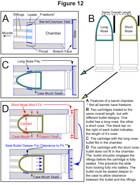

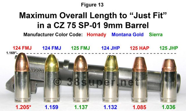

The reason why you should always determine your own OAL:
Examples of how your OAL will change depending on the bullet/barrel combo:
Plunk and spin video:
Campro 147 9mm bullet in 9x19, in a Shadow 1 or Shadow 2, should be loaded at 1.095" COAL in my experience. Any longer and you'll start jamming the bullet into the rifling, which can prevent the slide from going into battery.
I've never heard of OAL being the cause of tumbling in pistol rounds. It's all about stabilization in flight, like a football, the bullet needs to spin.
Having already loaded rounds that wouldn't chamber to begin with is pretty telling. Again, determine your own OAL. Make a dummy round, no powder or primer, barely seat the bullet, apply no crimp (just return the case mouth spec to .380 [ditch the mm]), and keep shortening the round until it plunks and spins in the barrel you want to shoot that round in.

Having already loaded rounds that wouldn't chamber to begin with is pretty telling. Again, determine your own OAL. Make a dummy round, no powder or primer, barely seat the bullet, apply no crimp (just return case mouth to spec .380 [ditch the mm]) and keep shortening the round until it plunks and spins in the barrel you want to shoot that round in.

Stuck live rounds is a clear sign of OAL being too long for particular bullet (including irregular-shaped bullet).
It's a totally different issue unrelated to stabilization. However it's probably a bad batch of cast regardless.
