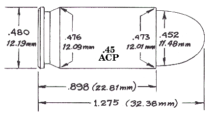

I just finished loading a batch of Hornady 230gr FMJ-RN. I compared them to the Remington UMC 230gr FMJ-RN that I bought and the remington ones are 0.030" longer. I looked back in my Hornady manual since I used Hornady bullets and it says for 230gr FMJ-RN, C.O.L. is 1.230". I managed to get most of them between 1.228"-1.232". Then I look in my Lyman 49th and it says that for a 230gr FMJ-RN C.O.L. should be 1.275".
Are my bullets going to be okay? I don't want the whole kaboom effect!:runaway:
Which manual should I side with?

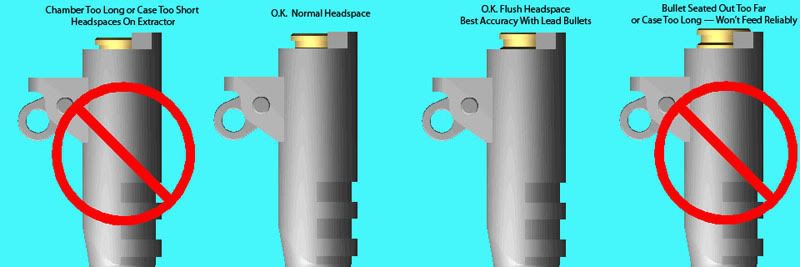

Use the barrel of your gun to determine OAL. For my 1911 it's 1.220

Thank you for this, its nice to have diagrams :)
But will this really tell you the overall length since the straight walled pistol cases headspace off the mouth?
I just tried with three different pistol loads in my glock 17, some factory ammo, some at 1.15" and some at 1.13" They were all virtually flush
You're correct. Size matters.
Hornady's COL = 1.230 is for the 230 gr FMJ HP ! Recommended COL for 230 gr FMJRN is 1.275
According to Quickload software the 45ACP 230gr FMJRN over 5.4 gr 231 with COL = 1.230 will produce pressures of 20,997 psi. SAAMI PMax is 21,000 psi.
Quickload recommends not using the round.
I cannot load to 1.275 they will not feed. I load 1.220" with 5.7gr W231 (230gr FMJRN) and have fired a few hundred with no issues. YMMV
EDIT: I went and measured and the RN I was using have a little bit of a flat nose that is why they are only 1.220" the equivalent in a real RN would be very close to 1.275"
What edition of the Hornady manual do you have? I have the Hornady 7th Edition and mine has 4 bullets for 230gr
HP-XTP: C.O.L. 1.230"
FMJ-RN ENC: C.O.L. 1.230"
HAP: C.O.L. 1.230"
FMJ-FP ENC: C.O.L. 1.200"
Can anyone else confirm this for me?
HAP: C.O.L. 1.230"
.45 ACP / .45 Automatic Handgun Data (Hornady Handbook of Cartridge Reloading 7th Edition) Reloading Data
[SIZE=-1]Printable Version[/SIZE]
[SIZE=-1]Warning! Notes: handgun: Colt Gov't Model; barrel: 5", 1 in 16" Twist; case: Hornady; primer: Winchester WLP; bullet diameter: 0.451"; maximum C.O.L.: 1.275" (C.O.L. for the 230 grain HP-XTP 1.230"); max. case length: 0.898"; case trim length: 0.893"[/SIZE][SIZE=-1]Be Alert: Publisher cannot be responsible for errors in published load data.[/SIZE][SIZE=-1]Wt.[/SIZE][SIZE=-1]Bullet[/SIZE][SIZE=-1]Powder [/SIZE]
