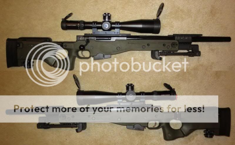

I have an Accuracy International 18 MOA one piece mount for this 4-16x50PMII scope (as seen in photo).
I learned today that the 5-25x56 and 12-50x56PMII's use a different construction where the "bulb" on the bottom of the scope sticks out considerably further (than on the 3-12 and 4-16 models) and you cannot use this (18 MOA) one-piece mount with them. The distance between the base and the rings is just not enough. you can put the middle of the base flat against the flat "bulb" of scope, and the bottom rings still won't touch the tube.

Here are some photos of my rifle with the 12-50x56PMII and the 45MOA mount, and the same picture from above with the 4-16x50PMII with the 18MOA mount. Undoubtedly I will have more to say about the scope in the near future. Eye relief is a little shorter on the big scope, which is why it is sitting back a bit further. It seems to feel/see pretty good where it is. I might have to make some fine adjustments as I go.
