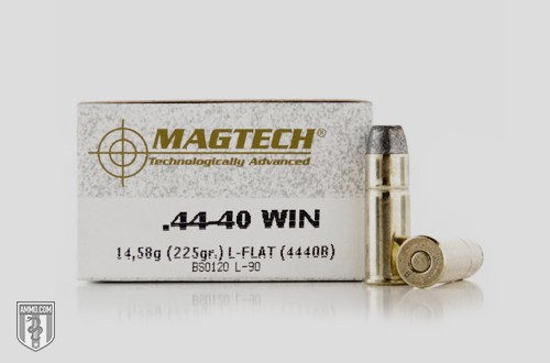

Magtech .44-40 casing maybe? Just a random guess.
