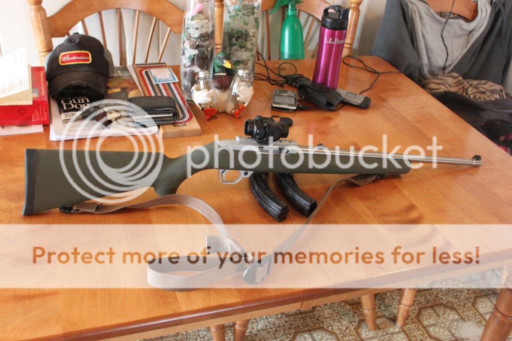

"First thing I would recommend for shooting offhand is a good sling you can use to steady/anchor your rifle,..."
The benefit of a sling in offhand is debatable and typically not beneficial if the position has a foundation based on bone structure using the muscles as support and balance. In 3position standing element,silhouette shooting and air rifle slings are not used and to no detriment as the practitioners have developed solid stances through training.
Without support of the arm the sling does virtually nothing - one would be better developing a position with the elbow and upper arm tucked against the side of the body and if possible resting on the hip bone.
