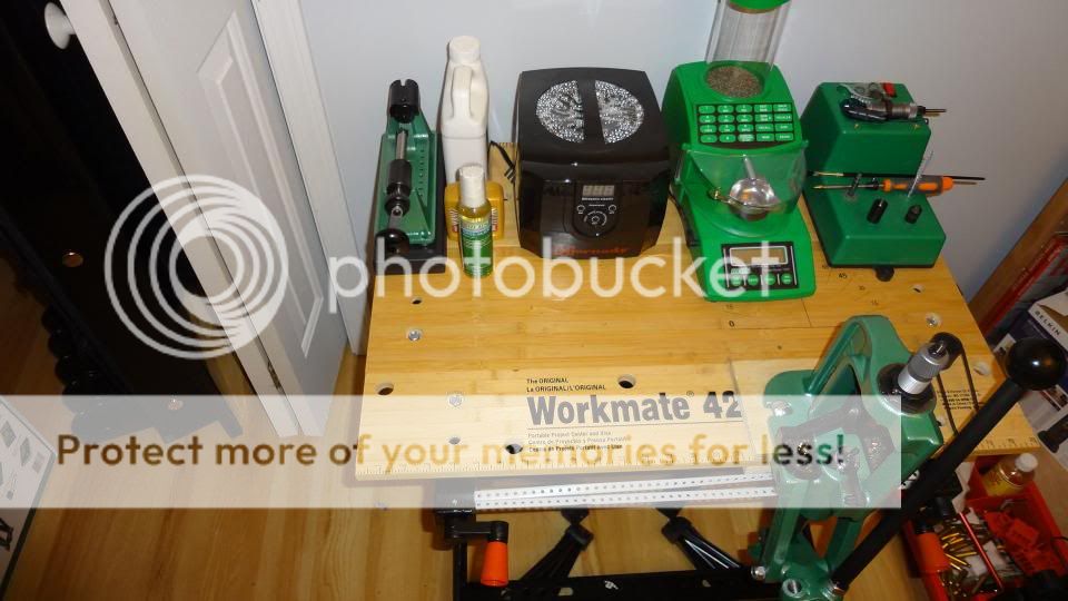

this is what i use for now ... just recently started reloading for 22-250 and works great .. right height and solid enough ... will build one soon but does the job for now. And no it not always that tidy!!!
