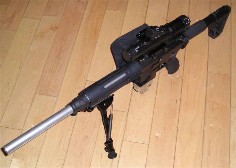

Inspired by ... making loud noises, here is my first AR. The laundry list:
- SOCOM MFG BR-15 billet lower
- DPMS parts kit, with JP Ent spring set
- ACE SOCOM stock
- Tromix .50AE "Sledgehammer" upper
- Ergo grip (really comfortable, ambi)
- Leupold CQ/T festooned with a J-Point as a BUOS ;) and tiny laser
- 3-Bucc brass catcher - works great, easy on/off.
- Harris bipod
Everything went into the lower just like that, perfect fit. The online build guides are great. Upper is tight. Target below. This will be a great pin-gun in carbine class, and should move the poppers decisively in multi-gun matches.

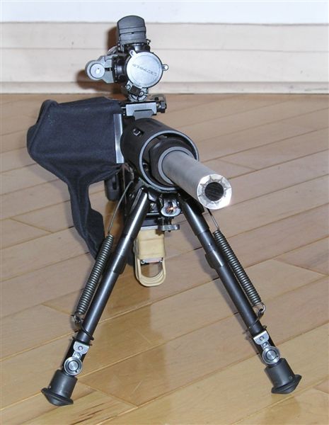

First, say hello to my big friend:

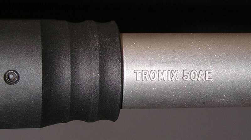

Tromix does great work - the upper build quality is excellent:

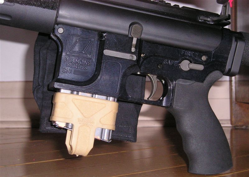

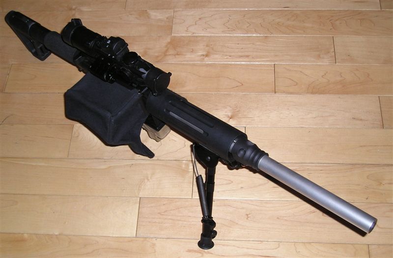

Your basic side shots:
One sweet lower:

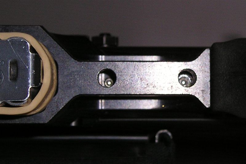

Which has built-in takeup and overtravel adjustments - makes the DMPS trigger feel like an expensive match trigger. It has some other features, but this one is the most immediately useful:

The upper is from http://www.tromix.com/Sledgehammer.htm . The .50AE is off the page (don't know why), but certainly the .458 SOCOM would help you wake up in the morning.
Tony Rumore is the man behind Tromix - call and ask about a .50AE upper - he'll build it any way you want, flattop, riser, slickside, whatever - then call Questar to get things going - it's a part, not a gun, so that simplifies things.
