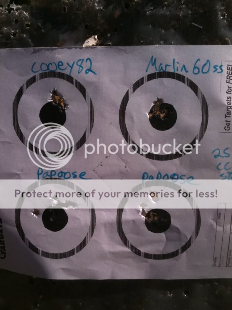

Old guns can shoot great. While ive not had a lakefield to compare, here's some groups I shot with a cooey 82 last summer. These are at 25m and 50m respectively, and were shot with the issue peep sight and thick front post. Not bad... And I only tried one type of ammo in this gun, so it may have tightened up even more with it's favorite ammo.
