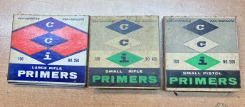

I came across a box of various primers the other day. One that interested me was C-I-L No. 4B. Used to reload shotgun battery cups. Also some No.1,No. 11/2 and 21/2, plus various Winchester, CCI, Federal and Remington. A walk back in time for some of us.
