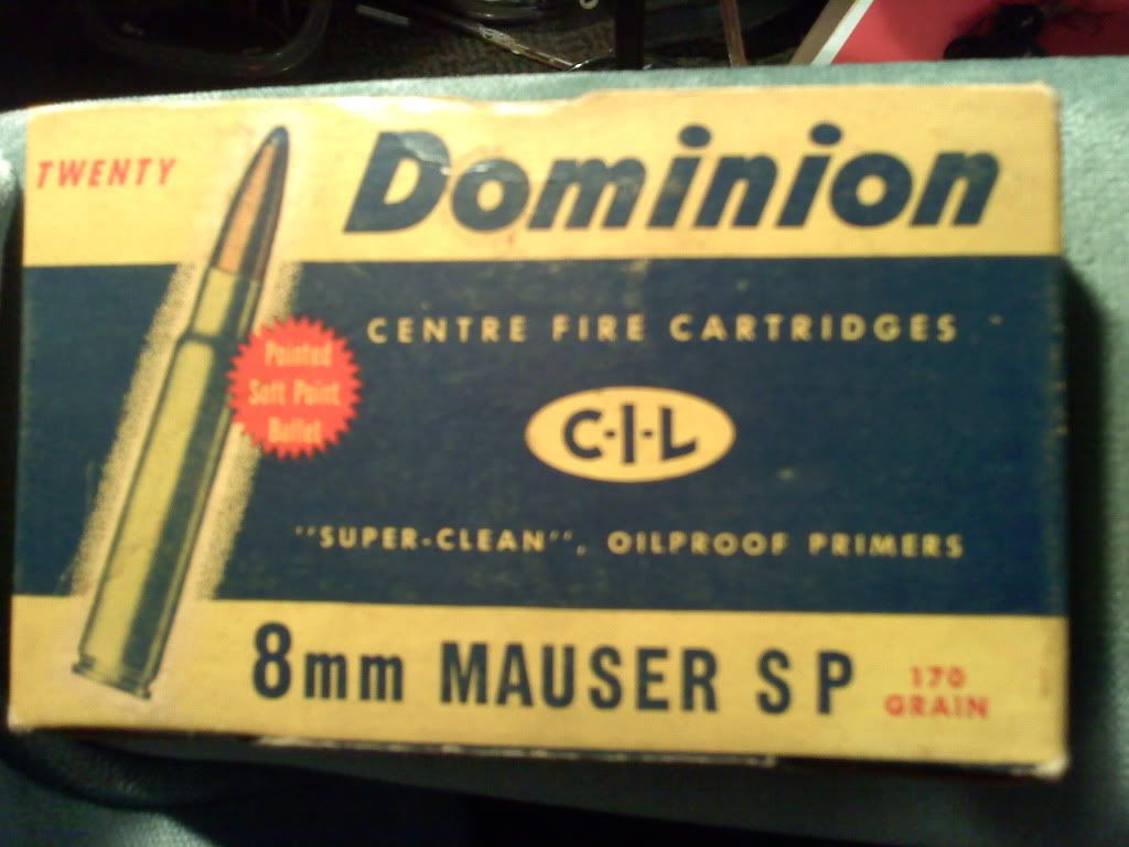

8 mm mauser
mayb the're theese ones
Pic

I have shot a bunch ot it, and it's the 170 RN. Announced velocity was 2570 fps, clocked 2480 fps through a Brno 21H. Pretty good brass.
OAL is 3.040" and it's loaded with 47 grains of cylindrical powder... They were common from the '50s to early '70s, before the name changed to Imperial.
