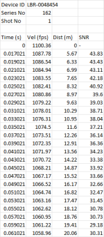

I verify my dope with actual shooting and let the results tell me or steer me where I need to go. If I input the info with good data, range the target and its 325 yards and it tells me 16.2 and it goes ping or the light flashes, that’s all I’m looking for. You might be seeking things I’m not. I had a quick look at your Labradar printout and was wondering how a bullet can gain speed in flight ??IMG_3922.png

I verify my dope with actual shooting and let the results tell me or steer me where I need to go. If I input the info with good data, range the target and its 325 yards and it tells me 16.2 and it goes ping or the light flashes, that’s all I’m looking for. You might be seeking things I’m not. I had a quick look at your Labradar printout and was wondering how a bullet can gain speed in flight ??View attachment 1174226
There's error in every measurement. That's why it is good to take multiple measurements. A measurement by a LabRadar device isn't exempt from this. Their manual states a margin of error of +/- 0.1%, which at just over 1000 fps we're talking about just over +/- 1 fps. So, really, the four numbers you've zoomed in on should be thought of as ranges like this:
1061.56-1063.68
1059.89-1062.01
1060.16-1062.28
1057.90-1060.02
The "gain" of 0.27 fps that you pointed out is actually just part of that noise. That's why you examine every measurement in the track and build a curve rather than looking at a single measurement, to smooth out error noise. As I mentioned, all of these radar-based chronographs do the same thing. They take a bunch of measurements and build a curve, and the "muzzle velocity" they give you is just a back calculation along that curve. None of them actually take a single measurement at the muzzle. None of them actually take a single measurement anywhere near the gun. The first measurement in that particular track was way out at 5.67 metres. It takes a new measurement every 2 milliseconds and calculates a smooth curve based on those measurements. The shape of that curve takes into account drag by determining how quickly it is slowing down. It follows that curve back to what would be the muzzle at 0 m and gives you that location on the curve as the muzzle velocity.
