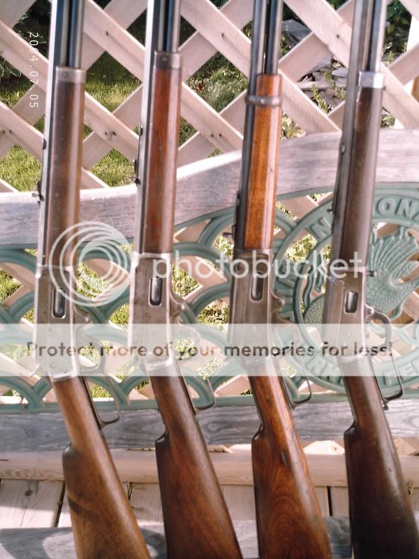

What was the caliber Doug? The 1889 was chambered in "pistol calibers" (32-20, 38-40, 44-40) while the 1893 was rifle calibers (30-30, 32WS, 25-36, 32-40, 38-55).
Quite a few of the first year run 1893's didn't have any markings on the tang.
Oh, and the 1889 should have a clip on the bottom tang to hold the lever tight.
Here's a pic:
It's an 1889 on the right, and the others are 1893's.

The barrel is marked "38W" which I did take to be .38-40. Barrel is 23.5" so was cut off just past the forward sight by the look of it.
In the pic, what is the little "tit" that hangs down below the forward part of the receiver on the 1889?
Doug
Doug
It'd be an 1889 if it's 38-40 (same caliber as mine).
The little "tit" - don't really know, came with the rifle. The thread on it is the same size and pitch as the proper screw (tried a screw from one of the 1893s). It's kinda like a old fashioned spliced eye bolt. :confused: Don't know if it had some purpose, or if it was just the right size so somebody used it.
I reckon it was an expedient repair. Every single one of the 1893s I had were home handyman specials, whether it was hacked barrels, counter-bored muzzles, home-made firing pins, springs of uncertain parentage, etc etc. The FP in one of them was a rusted nail (one piece, not two)..........:eek:
