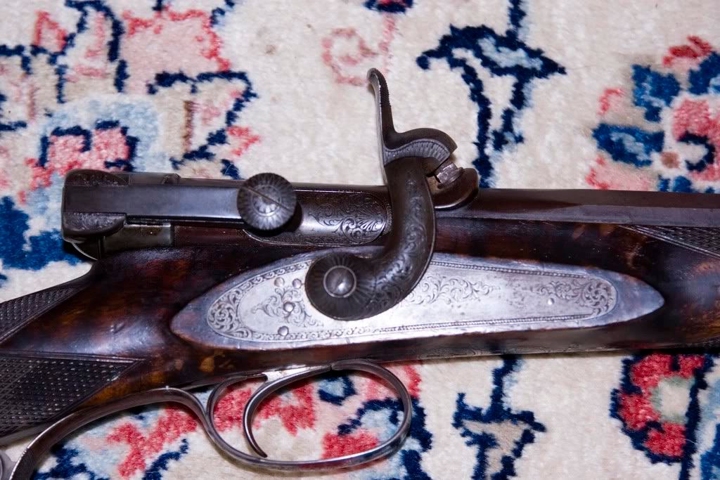

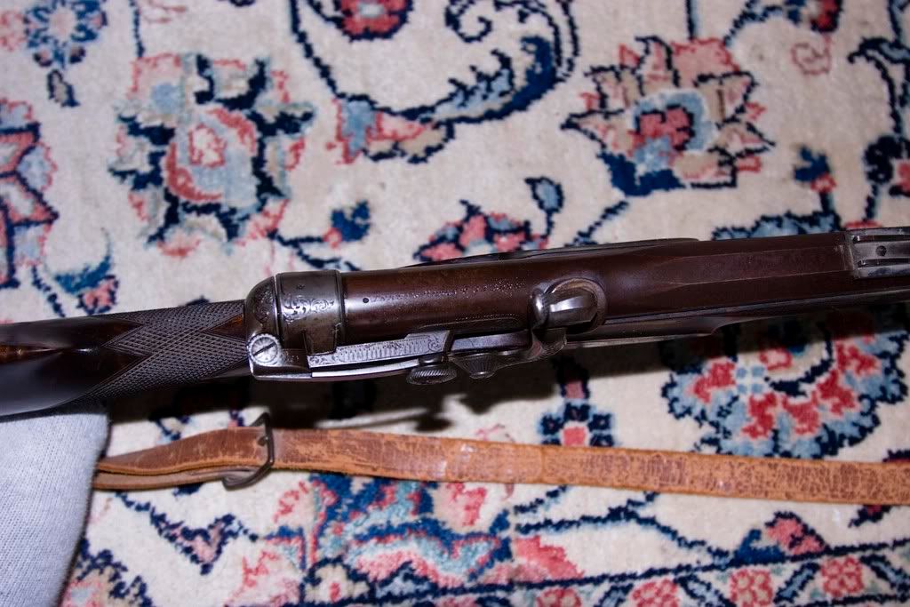

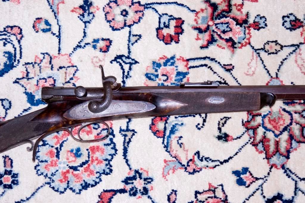

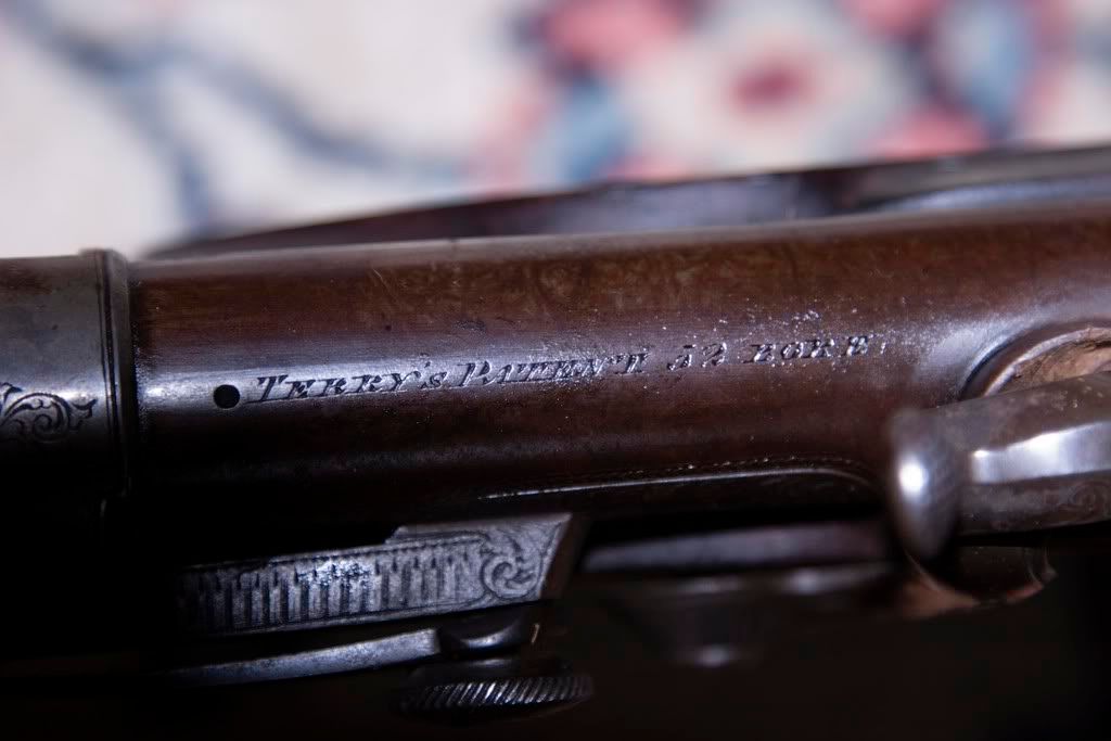

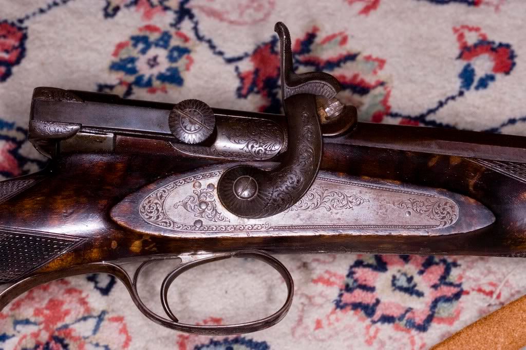

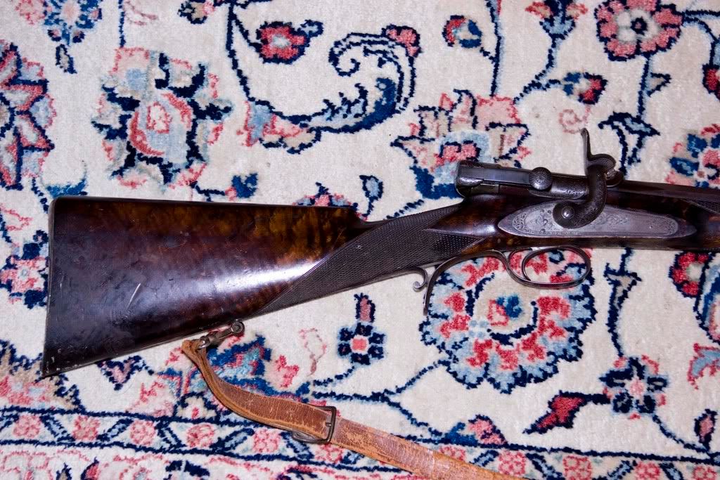

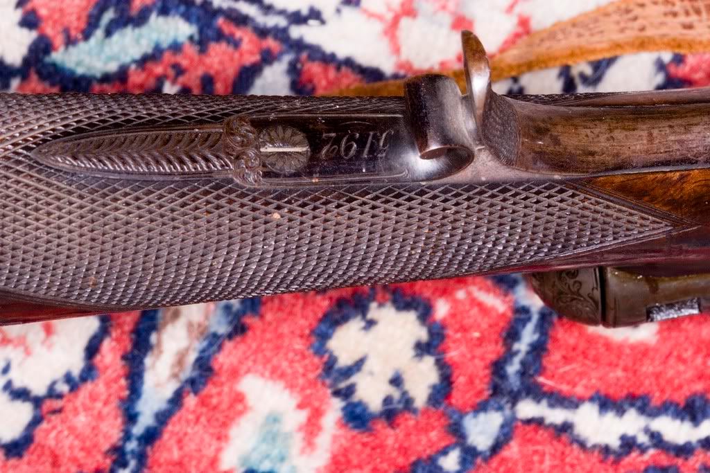

This rifle came up the Red River to Winnipeg around 1870. It was owned by my great grandfather. The only markings are "Terrys Patent 52 Bore" on the top of the barrel and 761c behind the trigger guard. It is a breech loader but uses a percussion cap. It is rifled and has an elevated/adjustable rear site to 900 yards. I found some information about Calisher and Terry gunsmiths in England but I would really like to know more about the gun, what type of ammo it used and what it looked like.....paper cartridge that is torn open? Thanks

Great photos and a fine rifle. Nice to see it stay with your family. Information is hard to find about these rifles. The only reference I can find is although it is a marked 52 bore it is .54cal. Denner has a Calisher & Terry shotgun for $3500. http://www.denner.ca/weapons/longguns/index.html Here are two photos of the carbine.

Although the military Calisher & Terry rifles/carbines were .54 caliber, yours is a sporting rifle built with that action, and should be about .44 caliber, based on the "52 Bore" marking.
As you may be aware, in the old British system for denoting bore diameter of firearms, the "bore number" (in the case of your rifle "52") denotes the number of pure lead round balls exactly fitting that bore equalling one pound in weight. I don't have a full chart handy, but "52 Bore" would be just under .44 caliber. The .54 caliber military carbine, on the other hand, was referred to as 30 Bore. (This is essentially the same system as still used to indicate shotgun bore size - i.e. "12 gauge" is the same thing as "12 bore".)
It should be entirely possible to shoot your rifle if it is in sound condition - there are lots of folks shooting both original and reproduction "capping breechloaders" (the general term for this type of firearm), so there should be plenty of information and help available online.
It would be necessary to use black powder loads, of course - if you are not familiar with black powder, be sure to learn about the very corrosive effects of BP fouling, and the proper techniques for cleaning and care, by means of which any damage can be entirely avoided. It would be a shame to ruin such a beautiful old heirloom!
