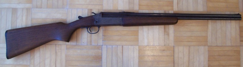

I was visiting an aunt earlier today, and it transpired that she still had my grandmother's old partridge gun, a Stevens Model .22-.410 over-under combo. This was the predecessor to the Savage Model 24, and was manufactured as the Model .22-.410 between 1938 and 1950. My grandmother's gun is apparently later production as it's stamped with a patent number; earlier models were stamped "Patent Pending". It's probably somewhere over sixty years old.
My grandmother was apparently an excellent shot, among her many other sterling qualities, and she reportedly bagged a lot of birds with this gun. Seeing it in person was a little saddening, as it was obviously stored in suboptimal conditions for a number of years.
000p8xp3

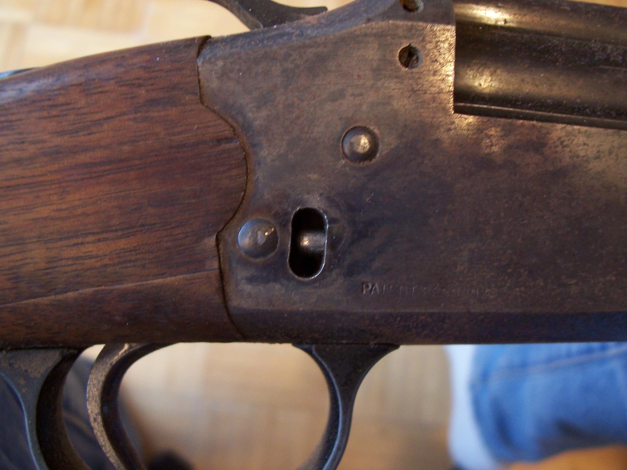

It's quite dirty, and there's a fair bit of rust on it, although nothing that I would call really heavy pitting. The stock is cracked on both sides, both bores are dirty-ish, although they looked fundamentally sound, and the selector button is missing. Also, the hinge doesn't seem to align properly, although the breech seems to mate properly. A bit of research seems to indicate that parts may still be available via mail order.
This image shows the level of rust, the missing selector button, and one of the cracks in the stock.

Sounds like you know what you have to do with it.
The Stevens 22-410 wood will be the same butt as the early Savage 219's, 220's and Stevens 94's as well if you can't find a model 24 butt stock.
The trigger selelctors for those are always on Ebay but Numrichs carry them as well. I ordered one from Savparts.com a couple years ago but Steve has since retired and closed up the shop and sold all his remaining parts (factory) to Numrichs.
You could order new wood... but the odl wood has some character, I would get some "flash" a glue available at some hobby shops, it is like crazy glue but will work where some oil may be present.
Just open up the cracks a bit by twisting the wodd or carefully pry it, then squeeze in some flash ( a syringe may be useful ) and voila good as new....
I also highly recommend getting some flash debonder, great for cleaning up drips and removing the stock from your hand. I was lucky enough to have needed some debonder to clean up a mess, just a day before glueing my hand to a stock.

My dad's an R/C modeller and has praised Flash to me many a time. I am overjoyed that I may be able to save the original wood. Thanks!

Thanks very much for the tips. Bill c68 has pointed out that I might be able to glue the stock back together; I think I'm going to try that first...
The rust on the receiver looks rather superficial. With the wood off, try using lots of oil, and a brass scraper, perhaps followed by some 0000 steel wool and oil. I think it should clean up nicely.
If it is going to be reblued, I personally would get some CLR (Calcium Lime Rust remover) and soak all of the metal in it. This will remove the blueing and any red rust, you will still have to use sand paper or steel wool for the minor pitting that the rust has left.
But sometimes it is worth trying just the steel wool and a little oil first. I had a 22/410 (newer type) and was about to disassemble the whole thing, but to my surprise, about 2 minutes with the steel wool and oil and I swear the metal looked new.
I think you are beyond that stage but it is worth a try.
