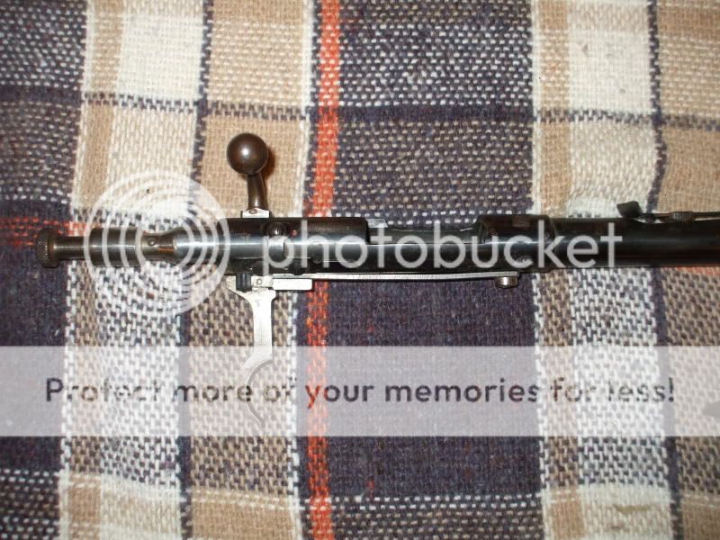

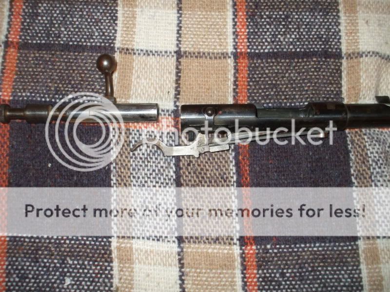

So, I removed the stock from the rifle last night and easily removed the bolt. It appears that the stock must be removed, then the trigger assembly folded completely to the rear, lowering the sear and disengaging the bolt.
Pics, in case someone else has a similar problem:
