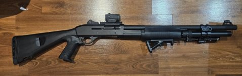

I have my "M3" modded to accept a mesa tactical urbino stock. Takes some chopping and a printed part but it looks good.
Wow man! That looks sick! Been debating buying one of these for awhile. Defiantly going to have to pick one up.
Looks great! Which flashlight/sling mount do you have on the front?
