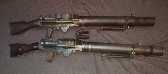

One for each hand... :)
KotKotofeich
77   0   0
Ottawa Valley
I don't know when I might have two of these here again as one will be leaving for Prague. It will have a home on a rental range so if you are visiting the Czech Republic you may have a chance for some trigger time...
I do have another as a stripped receiver in storage so if I ever find parts I will restore it.
They are an absolute joy to shoot. No recoil to speak of. The target at 300 yards was getting nicely shredded...
Tuning of the recoil spring is a pain, the armourer manual recommends 12-14 lbs and my trigger scale goes to 8 only... Had to jerry rig a contraption :) And still one had to have the spring tension loosened - I was getting super slow cyclic rate on the large gas port setting... Another interesting observation for me was that they're not as loud as I would have expected. The front of the cooling jacket directs the sound forward.
I'm not going to pretend that I got a lot of trigger time on them - it's not cheap - I did my best to replicate mk vii ammunition, as the 303 in the stores here is hunting ammo not to those specs...

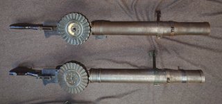

Merry Christmas to all... This is how I welcomed it this year...

Hi KotKotofeich. The Lewis Gun is a lovely weapon. I turned mine over to a museum before I had a chance to shoot it.
I am curious as to the magazine in the bottom gun in the pic. I am not familiar with that pattern. Is it a BSA made item?
I may have a home for your spare body. John

I'm not sure what the markings indicate. Does S stand for Savage? It fits 303 just fine so it's not 30-06, 7.62x54 or 8mm. I was told by someone with a Russian Lewis recently that the magazine is significantly different and I would expect the same for 30-06... I see magazines with this latch for sale at Apex so more support for it being Savage made?
There's an explanation of what it is
https://www.machinegunboards.com/forums/index.php?/topic/22700-early-lewis-gun-magazine/
Pictures of the drum markings below.
Otherwise, I'm not looking for a home for the receiver (no shortage of very willing homes already), but I am looking for parts to complete it.
