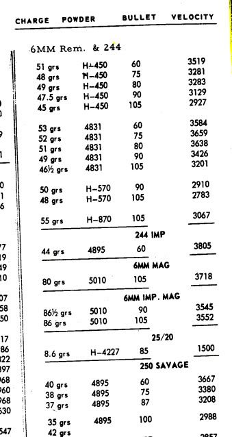

I guess when you start out reloading on this kind of loading charts and get used to using such information, you don't get too excited about a slight change in bullet design.
Notice there were just four headings; charge, powder, bullet and velocity.
The bullet was given by weight only. Also, no overall lengths. You seated the bullet to give about the right appearance, as long as the bolt would close, and for repeat firing, if it would cycle through the magazine.
The "charge," the powder weight, was what was deemed would bring the pressure up to SAAMI standards, in the average rifle.
In later loading books this term "charge," was changed to, "maximun." The word maximun has a somewhat sinister sound and it, along with other word additions and changes, changed the attitude of reloaders, forever.
That word "maximun," means exactly the same as the word "charge" once meant. It means the amount of powder deemed to raise the pressure to SAAMI standards. Nothing more.
And by the way, those SAAMI standards we're talking about is the same, that is the same pressures, as loaded in the factory loads for that cartridge. Thus, the powder charge given as a "maximum" load, will be the same as a factory loaded cartridge.
See what I mean about the word maximum being looked on as something sinister. I have yet to hear of a shooter that is afraid to shoot factory loads in his rifle, yet every newer handloader thinks it is a stupid idea to just load the "maximum," load given in the book for his rifle and shoot it. In reality that load will be the same pressure as loaded in factory loads.
