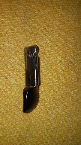

Anyways, on the initial range day the operating handle fell out, luckily I was able to recover it ... however it must have been a problem for the previous owner as well as it had copious amounts of JB Weld on it.
I disassembled the gun and have cleaned the JB Weld off, the ball and spring retainer seem to be working properly with good spring, the handle seems to fit in properly and is fairly tight however I'm told by vets at the club that it should be harder to pull out.
So a couple of questions ...
1) Apparently there are two types of handles, how do I know if I have the correct one for this gun?
2) Any suggestions on how to make it snug in a little tighter?
Thanks
This is the one I have now:

Nope IMO you have a pre 87 gun ( wood for sure is around 76-81 )with the wrong operating handle which is why it is more than likely falling out. I have never tried a new style handle in an old gun
It is a fixed choke barrel which makes the barrel prior to 86

This is the correct handle the first design
Funny tho ... when I took it all apart I do have the carriage with the spring loaded detent ball that clicks into the notch in the operating handle I have ... so it appears to be the correct handle ... so that would make mine the newer model wouldn't it? I have never seen the old style carriage ...
You have vintage wood and barrel 100%. What you have for a RECEIVER I don't know but 78 more than likely from what I can see of it. Is it stamped TRAP
The bolt is scrolled on the chrome vintage one and plain on the new style except for the odd one like some 86 models
I cannot tell from the small pic what you have
Also the bolt could have cracked over the years which was common and replaced with a newer bolt/bar assembly
Even if it is the second generation replace the handle regardless since one can see wear on your handle and check that bolt over well for wear and cracks
Not rocket science here.
If old style bar you have the wrong handle if new style your handle set up needs to be replaced with new
There is only two handle options based on the bolt / bar(s) that I know of and vets are telling you it is too easy to pull out so change it with new parts

Regarding questions:
1) operating handle is this the correct one? Remington only offers 3 types of handle now, 12g, 12g nickel plate and 20 g this looks the same as the one I have 12 g model F92034.
2) how to make tighter? Something could be worn out. I would check clearances of the operating handle and the action bar. If both are good I would check operation of the detent ball and spring.
