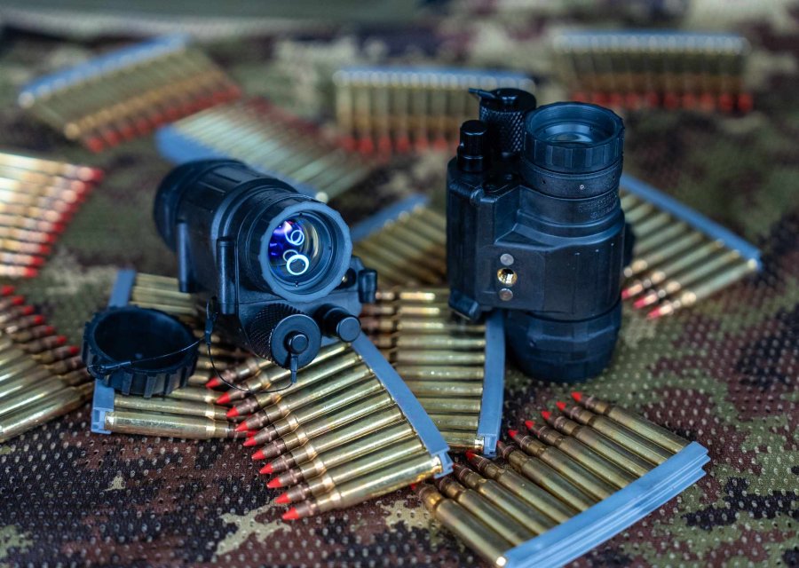

Black Friday EON PVS-14 Ultralight:
$3,695 now: $2,295!
1400+ FOM NNVT Tube with Manual Gain
Imported PVS-14 Housing
Rochester Precision Optics Commercial Optics
$4,345 now: $2,995!
1600+ FOM Autogated NNVT Tube with Manual Gain
