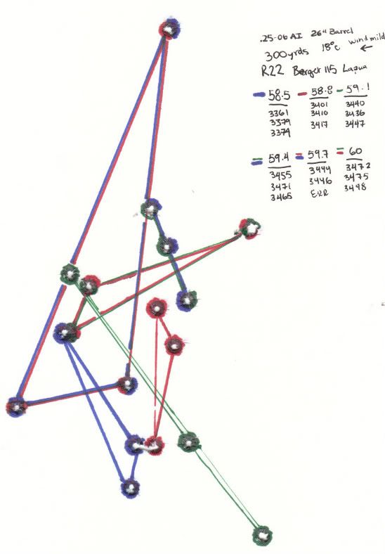

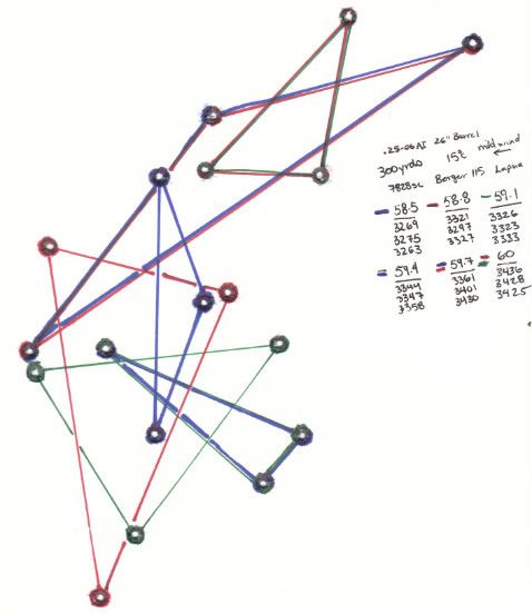

Finely had some time to test the .25-06 AI Cooper Excaliber with 26" Barrel. Your opinions are wanted in helping determine a good OCW load.
Ladder Test.
Components:
- 115 Grain Bergers (.05 off lands),
- Lapua 30-06 Fire formed brass,
- CCI BR2 Primers,
- Reloader 22, and
- IMR 7828sc.
Conditions:
- 15-18 Deg,
- Mild right to left wind,
- 300 yards,
- busy range.
1st Target at 300yrds with IMR 7828sc:
I was thinking for Target 1 / 7828sc would be best to look around the 59.1 - 59.4 range.
2nd Target at 300yrds with R22:
For Target 2 / R22 would be around 58.5 - 58.8 range.
300yrd was a little close as the targets are pretty clustered, I went .050 off lands as the prior tests with R22 showed it to be the most accurate with .010 off coming in second.
Quickload shows I can go about another grain or so up in powder charge for both powders but I was just starting to see pressure signs at 60grs, and with more then enough velocity call it my Max.
What do you guys think?

Velocities are posted on the targets, this Barrel is pretty fast which I believe has to do with treating it with Gunjuice when new. These loads are at the top level as indicated mostly by the velocity, as even at 60 grains pressure signs are minimal.

Cummins4x4 I noticed velocity is above published data for a .257WeaMag, Quickload says these loads are just under 60,000PSI and the lack of pressure signs corroborates that to a degree. Having said that Velocity comes with added pressure, so the Gunjuice may be working as advertised.

Ladder test looks like it likes RL22 (7828 looks consistently mediocre) and it looks like you should try at 57 grains and work up from there. Best nodes seem to be 58.5 and 58.8, but since those were your minimum loads, I'd love to see what it does with a bit less powder. That's probably a good thing as that round will be tough on barrels on a good day.
A Sierra 117 or a Hornady 110 might be a good option as they are far more seating depth tolerant. Looks like it has real promise!!
Thanks Obtunded I'll drop down to the 57gr area and work back up to see how she preforms. I'm going to see if I can get the Bergers to fly as I have about 300 left to burn. The Nosler 115gr BT's showed real promise when I was fire forming, and the test target that came with the rifle had 3 120gr Sierra's in one hole.
