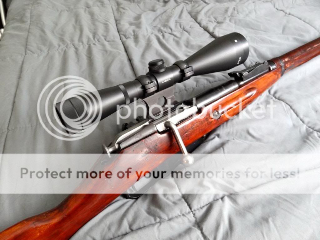

Mine works great, good way to run modern optics on your mosin sniper , i only bought the mount cause my rifle already has a PU base . heres some pics

Man, it sure looks high. But it is going on an Archangel stock, so I have the adjustable riser. No problem using the opens sights I am guessing! Does it hold zero?

It sits just as high as a standard 3.5x PU scope and even with the bent sniper style bolt handle on my rifle it does not leave much clearance , could not put it much lower without the bolt handle hitting the scope when you open it , true to russian doctrine it leaves room for the use of iron sights , i use a cheek riser that straps on the buttstock works well .What are your plans for your bolt handle? thats the main issue when mounting a scope on a mosin , cant use a straight bolt unless you use a scout optics setup. .
