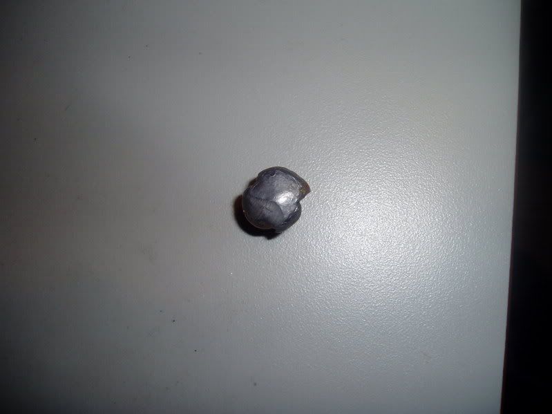

Here's one recovered from an elk....Rifle was a Browning BLR in 308....Bullet 150gr.
Russ...
Have used Grand Slams on two elk. Recovered one bullet from a mature bull that was embedded in his hide after travelling through the vitals. Great performance. :)

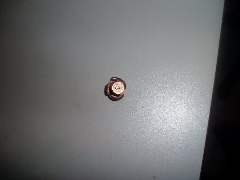

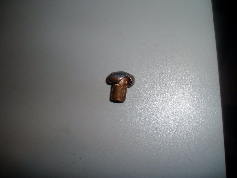

We have had great success with them, the only core I lost was after the bullet went though the head of the forkhorn, burying in the tree right behind it! Picture perfect mushrooms at all ranges from 40yards to 200 in:

I guess you could say I like them too!
Only down side is their low B.C. but for most hunting applications hitting game within the 200 yards, most about 80 yards, you'd never know the difference.
Their "mag tip" nose doesn't deform under recoil in the mag like a Partition.
