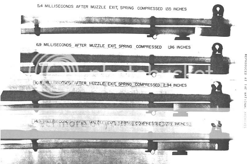

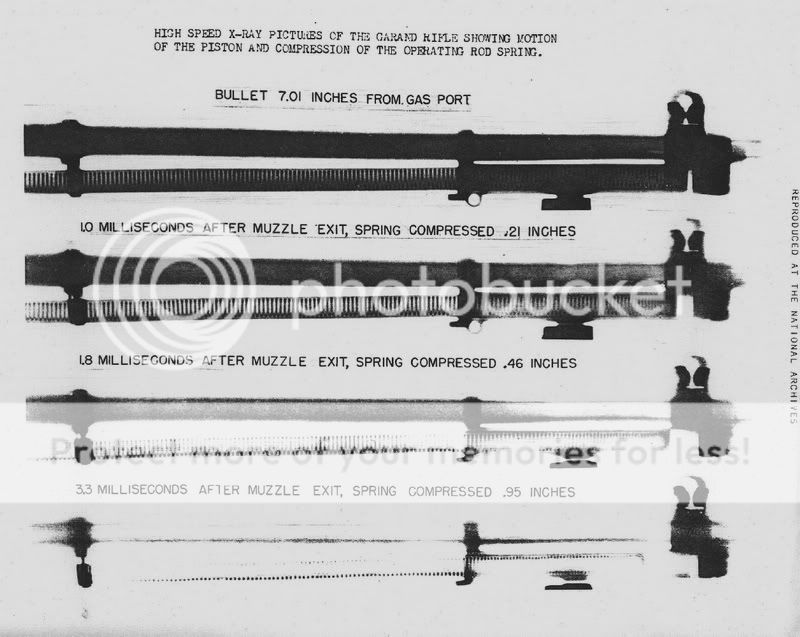

Gentlemen,
These photo's are of the op-rod spring taken using X-ray's. It shows us the Compression as the bullet has left the barrel. I think this will be of interest to you older guys as well as the new guys. It might help some of you that have ask about data on the op-rod springs.
