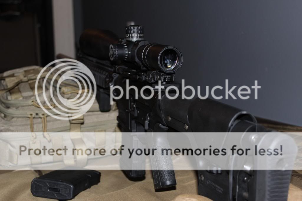

I have the Trijicon 5-20 on my DPMS LRT-SASS in .308. I have a NF 2.5-10 x 32 on my 18" AR15. I wouldn't discount the NF if you're looking in that up to 10x range. No complaints with the Trijicon either.
