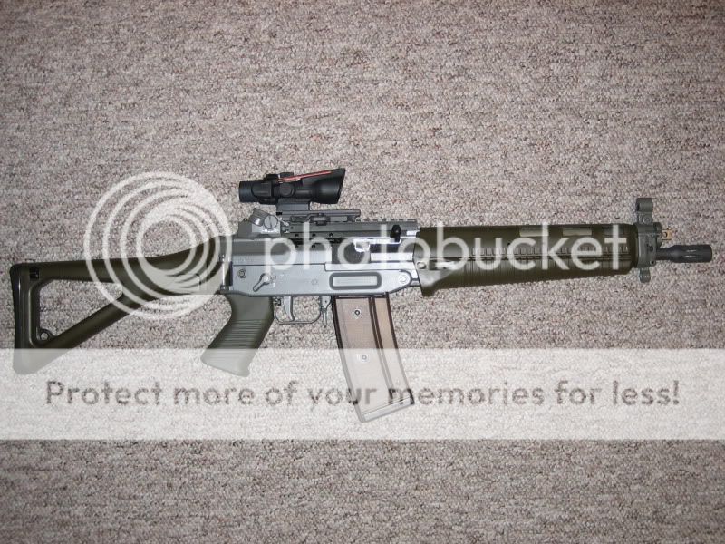

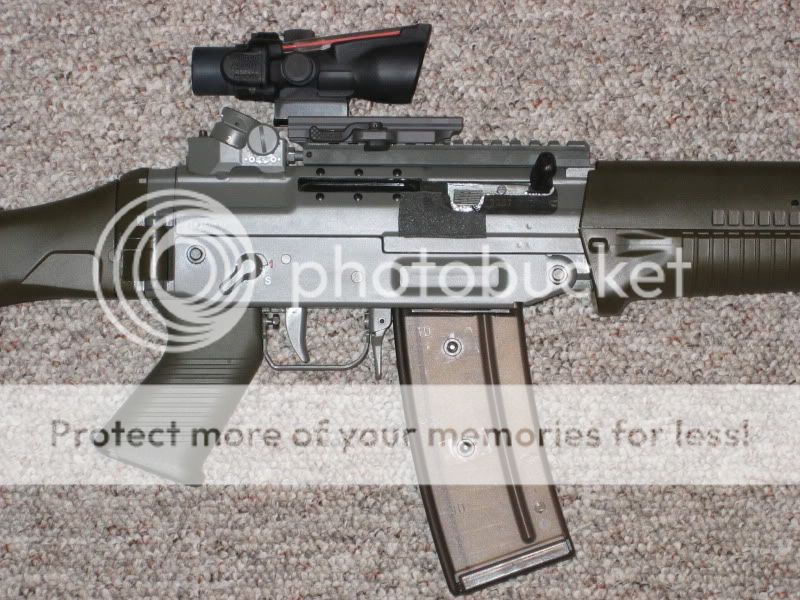

I have mine set up this way: 14.3" carbine, Kyle Precision rail, 3x ACOG Compact (TA50R-4 Red Crosshair), A.R.M.S. #19 S mount (mounted backwards to get the proper eye relief with this sight... which is only 1.4" ... which then puts the throw lever on the wrong side in my view... have to be conscious of not hitting it with your hand when using the charging handle).
Great rifle, great rail, great sight, good mount ... however, adding them all together does not produce an optimum system - certainly not in terms of dollar value invested. The sight just sits too high I guess.
The issue has "solved" itself, in a sense, though, as the ACOG Compact is going over to mate-up with my new M4-type rifle. For the Swiss, the Kyle rail stays (I don't think there is anything better) but I go back to the drawing board in terms of optics. Probably shoot it just with irons for the time being. Optics is a lot trickier a problem with Swiss than with something like an AR (which most of the cool optics are specifically designed around).

I have the Kyle rail, but presumably all makes attach in a very similar/same way. On the top of the receiver, at the front, right before the handguard... you will see a trapazoid shaped thing (a dovetail), wider toward the the front of the gun and narrower toward the rear. It has a Swiss cross on it. Well the rails have a cut-out in the same shape on the bottom/front. You slide the rail onto that, and then there is a "bolt" that fits into a dimple on the front of the diopter housing. You just tighten that bolt/nut thing back until everything is secure. Then there are two small hex screws on either side which you tighten up to prevent the main bolt from working loose. When the rail is installed, it does not touch the top of the receiver, except on the dovetail and where the bolt fits into the dimple.
You can sort of see the dovetail in this photo:
You can see the nut that push back against the diopter housing in this shot:
