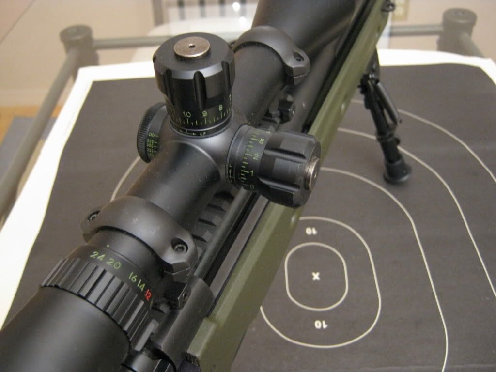

Firstly, let’s look at the 3200 fixed 10x – this scope which can be had for under $300 is one of my all-time favourite ‘value for money’ scopes and it is the only 1” tubed scope I’m covering in this review. This scope, like the others I will comment upon, forms part of Bushnells ‘Tactical’ line and that means it has exposed target knobs and some other ‘Tacticool” features that may or may not be of real world use but, nevertheless, appeal to many people. The fixed 10x with a 40mm objective is a simple scope with bags of eye relief, good internal adjustment and a mil dot reticle. Light weight and uncomplicated it is a robust scope that I have used extensively on both M14 and AR 15 platforms and I have never had a failure ( M14’s are hard on glass and are a good test of a scope’s durability ). While I no longer own one of these scopes I would have no hesitation is saying that if you are looking for a cheaper fixed power scope then this scope is hard to beat – current Bushnell catalogue reference is ET1040.
Moving up in price to about the $7-800 range is the old Elite 4200 6-24x50 Tactical. This is one of my all-time favourite scopes and was the one I bought when I upgraded from the Falcon Menace’s. At one time, I had four or five of them I still own one that sits on my .300WM Remington/AICS. Bright and clear glass, 100% repeatable adjustments, good eye-relief, a 30mm tube and easy to use controls with 1 click = ¼ MOA adjustments this scope is also a very good ‘value buy’. One downside to this scope though is the limited internal adjustment – IIRC it is a mere 40MOA – and so this really necessitates the use of a canted rail and even then the LR crowd may find this scope runs out of elevation.
At the $1000+ price point is the Elite 6500 Tactical 4.5-30x50. I have one of these scopes and, since I plan to sell it, I should bull this one up but I like my reviews to be honest and credibility is one thing that I’d like to hold onto so I have to call it like I see it. This scope is disappointing for the price – using my 1960 eyeball I have to say that the glass is neither as clear nor as bright on these scopes as it is on the 4200 6-24 x 50 and the increase in magnification from 24x to 30x power is not worth the increase in price. Overall, and the 6.5x magnification range notwithstanding, I cannot recommend this scope at the price point it is sold at as there are much better choices available and, as said, I consider this scope to be beaten out by its’ lower priced sibling the 6-24x50. I guess having said all that I will have trouble selling mine now but I'd rather be honest than BS to make an easy sale
While the Elite Tactical scopes generally have much to recommend them, they do have a weakness common to all and that is the reticule. While a useful and universally popular Mil Dot, the crosshairs are simply too thick – looking through these scopes at distant targets is like looking through a wrought iron fence !. Furthermore, Bushnell - no doubt appealing to the ‘Tacticool’ crowd - did one stupid thing with these scopes; they ‘blacked out’ the controls, replacing the easy to read gold lettering with hard-to-see green lettering. With my 50 year old eyes this makes seeing what I am doing quite tough and reaching for a pair of reading glasses so ruins the image that many of us mall-ninja’s try to achieve lol !
