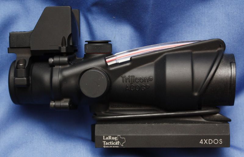

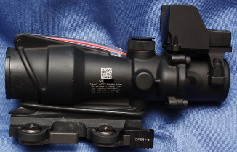

Trijicon ACOG 4x32 BAC with Doc Op
This particular unit is equipped with ARD and came with Tritium and Fiber optic making it very versatile in every lighting condition. Mounted on top of the ACOG is the Doc Op (Docter Optic) red dot. The unit sits in a Larue Tactical 4XDOS QD Mount. Reticle is a TA31-C.
As cool as the Trijicon series is some built in features that was made with the US military in mind that must be taken into account. This model has a BDC that is calibrated for 14.5" barrels shooting M855 spec 62 grain projectiles. Being as how M855 is difficult to source presently a person may not be using the BDC as it was calibrated. Another option is to reload to as close to spec as possible.
Another thing about this is that it is a med-high mounted optic. Making something in mind for the "lowest common denominator" in the military eliminated the possiblity of rings, and the height must take into account the armour and gear worn by your typical rifleman. Magnification is a constant 4x which again eliminates room for error.
Where most people may think that 4x magnification is too much for close in shooting and fast aquisition the Trijicon was made with the BAC (Bindon Aiming Concept). The BAC allows for two eye open shooting and makes for a bi-focal picture when you keep both eyes open which can make for "good enough to get the job done" shooting. For times where some magnification is required the user just needs to squint or close the non-dominant eye and the reticle with 4x magnification become instantly clear. This is yet another feature meant for the main purchasing client and to give some versatility to the glass with eliminating the room for error.

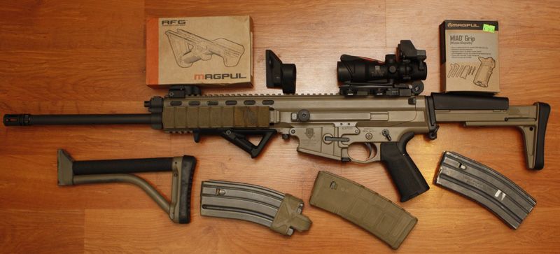

I apologize for the crap pic, it's what I can find as the XCR is now sold. I had this XCR setup with a fast stock in the middle position (the fast can be screwed into three positions for height adjustment) with the cheek riser in the top position. The top stock position was too high with a proper cheek weld and didn't allow for good sight picture, but the middle stock position with the cheek riser in the top riser position was perfect.
As said the Trijicon mounts high, and requires a platform that can be somewhat customized to the user and optic.

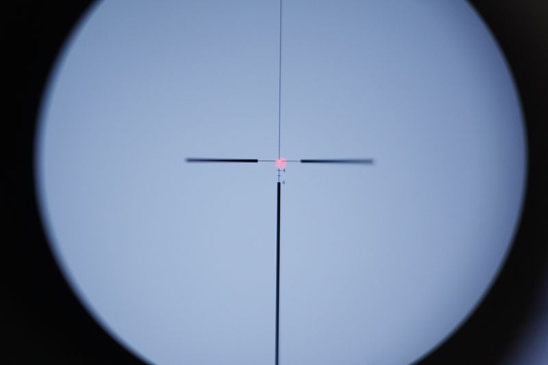

The Trijicon 4x32 BAC is a good and clear optic. This glass is clear to the edges and had a great field of view with little obstruction from the reticle.
The BAC makes for fast target aquisition and this would make for a fantastic competition optic allowing you to shoot with both eyes open yet have the added benefit of magnification where needed.
The reticle is bright in the daylight to low light, and being the only colour in the constantly illuminated reticle is fast to aquire.
Darkness and low light the illuminated reticle isn't to bright as to be blinding. With consistent rifle shouldering and cheek weld the reticle is fast to pick up in the darkness, and doesn't require messing around with switches. In very low light to darkness where 4x magnification doesn't matter the BAC and Tritium illumination is a wonderful combination to allow for both eye open binocular sight picture as the reticle just sits infront of the dominant eye and floats nicely over the target.

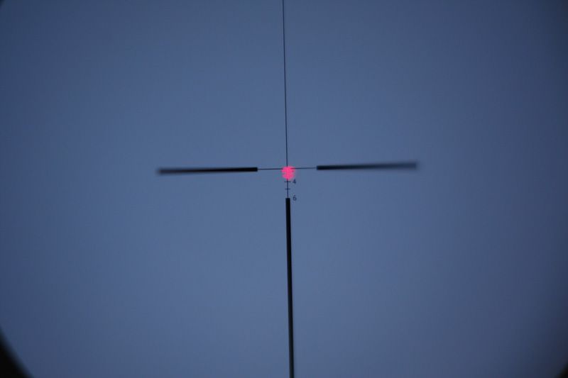

The reticle can give a halo effect with too much light present and become blurry. This is caused by the light gathering capability of the fiber optic.
Although it allows for an excellent non cluttered sight picture the center reticle can be considered a little small. For those needing corrective eyewear it may be a little hard to pick up.
Dark and low light illumination of the Tritium can be a little weak and difficult to pick up. Perhaps it was just me and the dark didn't combine well with the red for my eyes, but it could be difficult to pick up but still better than nothing. Darkenss testing was done with 30 min eye adjustment to low light, then shouldered with consisten cheek weld. The Tritium at the time of testing was new and not degraded.

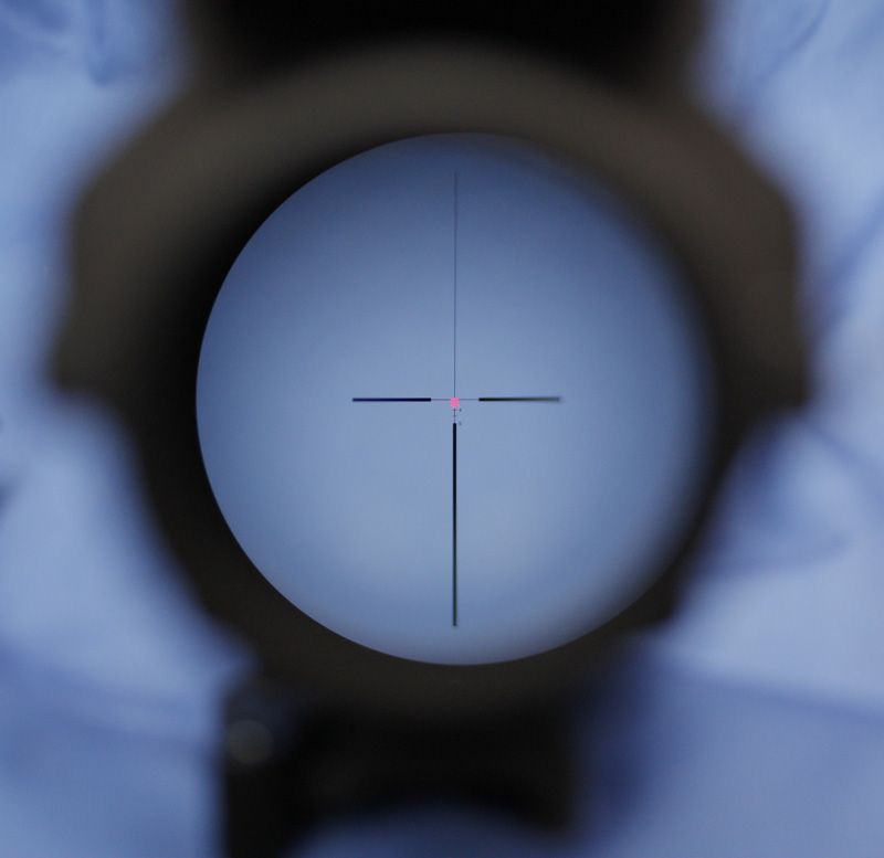

Demonstrated here by the flash of my camera is the halo effect of the illuminated reticle. This is one of the good pictures and I chose it so you can still see the reticle, below is one of the 'bad' pictures with halo effect.
The reticle halo under extreme light (camera flash) in it's full blinding glory.

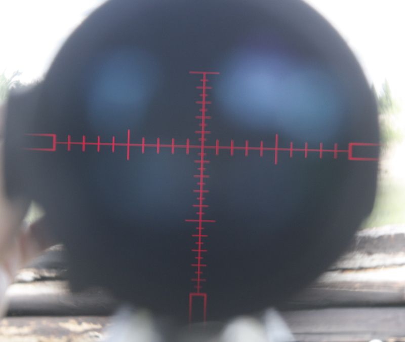

Above is a enlarged factory diagram of the reticle.
