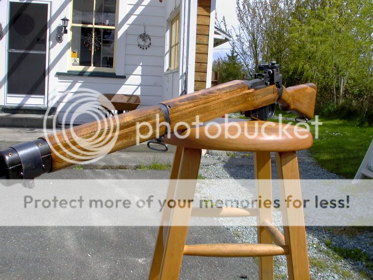

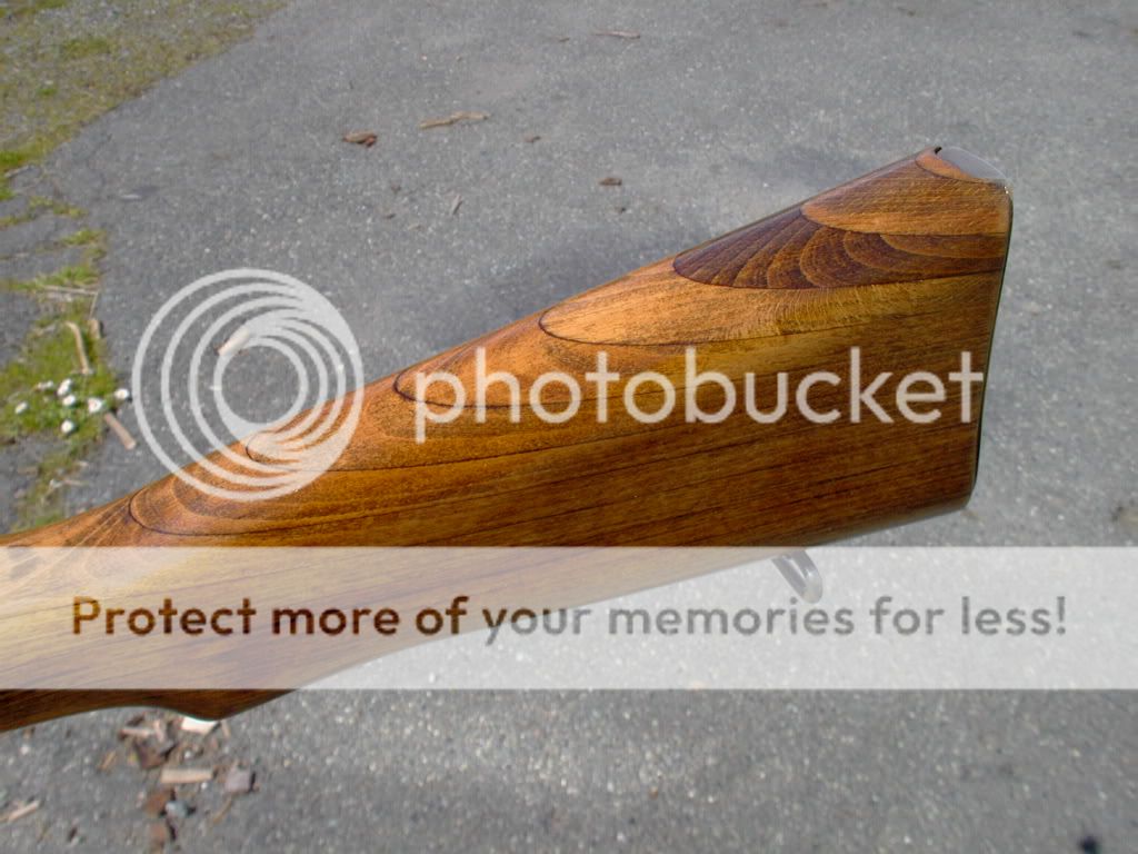

Note the rifle pictured was in fact bought on Vancouver Island the previous owner saying that he had owned it since the sixties and shot cast lead from it and maybe 30 FMJ loads.
The bore is pristine and measures at .3025.
Mechanically the rifle is perfect.
Visually it is stunning.
Most laminated stocks were bought or given to DCRA shooters.

Hmmm. That's a little different from what I expected. Normally laminated stocks are made from veneer like plywood. This is more like gluelam.
