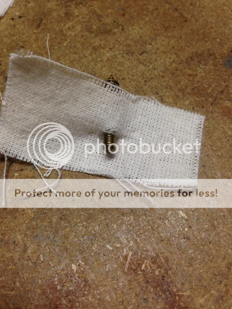

I now use an OTIS pretty much exclusively. When I think about it, bench resters clean their rifles from chamber to muzzle, so there must be a reason or merit to it. AR guys clean the same way with exceptional results. Until the OTIS, that wasn't an option for us. Now it is I actually cut a patch and screw in a jag on the cable and I pull the jag/patch through the barrel from chamber to muzzle with good results. I really don't use a solid cleaning rod any more.
