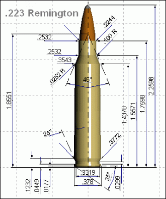

I know. I wish I could find one. I have the case trimming attachment and lock nut from Lee but I can't get the cartridge holder and depth rod.
I am not shooting match. I am just trying to save a bit of money and supply my Mini14 and my M4 ( AR clone ) with safe shootable and hopefuly accurate ammo. All .223 caliber. I just want medium loads. I can't believe the inconsistant brass and it is all Winchester.
