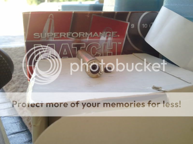

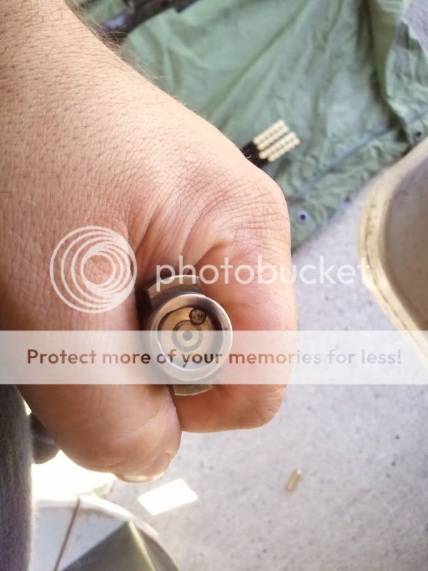

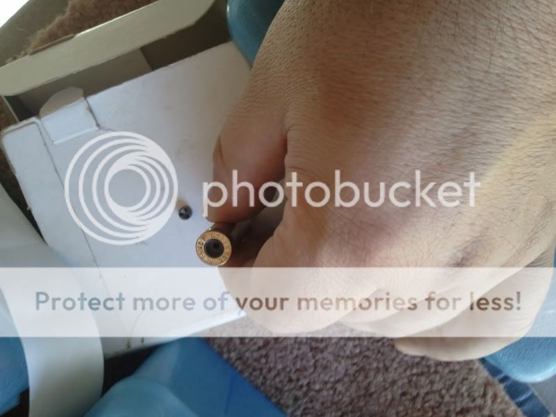

I picked up a couple of boxes of Hornady's Superformance Match 168gr A-MAX ammo .. and off for a range day. Fired the SASS with my own hand loads, worked out great, then switched to my custom rem 700 308 built by a excellent smith out of Kamloops .. None the less, have shot various ammo out of this rifle with no problems .. Started off with the Superformance and it was a grouping I couldn't believe - approx 5 inches which this rifle holds less than dime sized groupings at 100 yards. When I noticed the final shot was 5 inches high and the large black plume of smoke from the gun. I had to force the bolt open and I noticed the primer had pushed out and the extractor was broken and jammed. I picked up the brass and noticed 2 other cases had the primers missing that ended up sitting the mag. I have talked to Hornady and they are replacing the ammo and will fix the rifle at no cost .. I pulled a couple of the bullets and weighed the powder: 1 at 46.3gr and other 2 at 49.3 gr of their secret recipe. The primer pockets are twice the Normal size now.

that looks like the ejector is jammed back the extractor looks fine.
every manufacturer is going to have hot batches now and then. its not good when it damages a rifle. but replacing the spring behind the ejector isn't that bad of a cost. rems are generally pretty strong, seen some take a case that melted down (so much powder it cut the back of the case open and split the side of the case) all it has was a crushed spring under the ejector.
