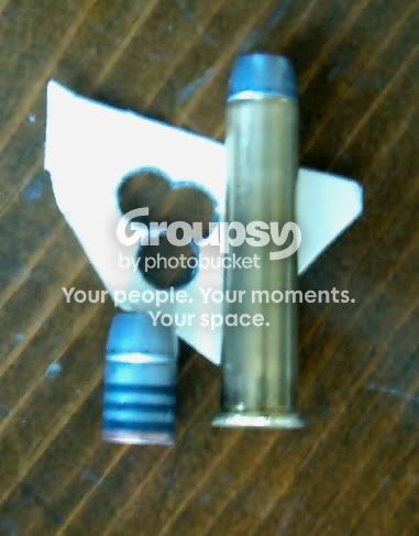

As for the casr 30-30, I'd love to see what bullet/load your using so far. Like I said before the toughest of alloys and bullet designs is still a fragile thing to get going down the rifling accrately. This is why I was telling you that the bullets NEED to be of harder alloy than lead and tin. You really are making glorified musket balls there,,(I'm not kidding) You gotta get the lead out LOL and wheel weights in. Drop them in water outta the mold taking care that not a molecule of water can fly back into the hot pot. Then let em sit atleast one week. When you do this you ten times further ahead. If your bullets are soft which I know they are load development dont mean diddles. And cast with a rough bore. I mean bro. lets put it this way if your going to start with so so so many ingredients for disaster let me know when you wanta sell off your pot, I can always use a spare. My guess would be that this spray you talk of is lube. On rare occasion I've had that. I'd be very surprised if your seeing lead fragments..You dont mention any hitting in keyhole fashion. This is a good thing
Now go back and look at Rick's pics cause if we all posted animal pics that would help you far more...Ok Rick you stand here whilst I get the trajectory right

10 Gr of Unique will drive that bullet at around 1450 fps on avg with standartd deviation of 11. The load is a great little plinking load and is accurate in my 30-30 out to 50 yards. I still have the original buckhorn sights on the gun which, with my eyes, limits any call on accuracy. I have also used WC735, a surplus powder from Higginsons, under the bullet with good sucess. 25 gr pushs the bullet out at around 1975 with a SD of 9in my rifle. This load is accurate out to hundred yards.
All my bullets are water quenched out of the mold and gas checked. I size them .309. cartridge length is 2.560 with a very mild crimp. I use wheelweights as my alloy and occasionally will add a little 50-50 solder to aid in mold fill out. I have yet to experience any leading. I use Felix lube in all my applications (Rifle & handgun). The formula is located on the cast bullet forum. It is a soft lube and has worked for me in both my rifles and handguns. Since you are into making your own lube you might want to try making up a batch.

Nice picture suspect good eating. Well done. blacksmithden is crawling right now, lets try to get him walking before we put him in a sports car. Whether or not he decides to pursue the silver stream or toss it all and take up badminton is an issue for him to decide. His recent experience will either drive him further into the witch craft we call castng or send him back to the mundane world of jacketed bullets or worse yet factory rounds. I suspect the former.

The roosevelt I shot some 4 yrs ago with cast in the 45/110 was 7x7 with a kicker on the right. All estimates in said aprox 1100lbs. Shot was 311 yards on range finder. Wasnt spooked, went down fairly cold, shot nicked heart and busted far shoulder. That monster hung like forever. We're not all that long done chewing that monster into us...Nice trophy yes, but waksupi on boolits is right when he says one that size is good fer patching your car tires. Some exageration there, but I've found with hooved animals, its good eats or good trophy. It seldom fits both bills perfectly
Yours dont look much good for either Rick
