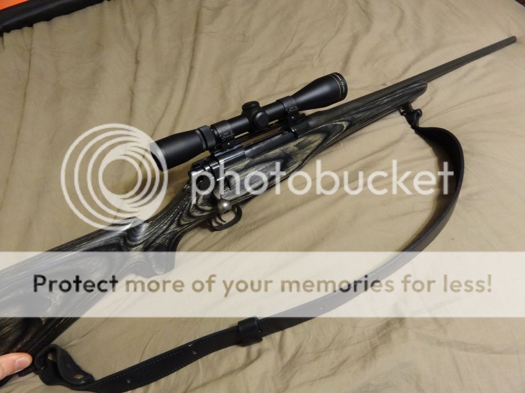

You or a gunsmith will have to put some sort of scope base on there , the smith charged me $80 to put a base on my P17 .. So you should be able to turn it into a nice hunting rifle for $300 or so , then you need a optic too .. heres mine, the Leupold rifleman scope just clears the bolt handle . it shoots one inch groups at 100m
