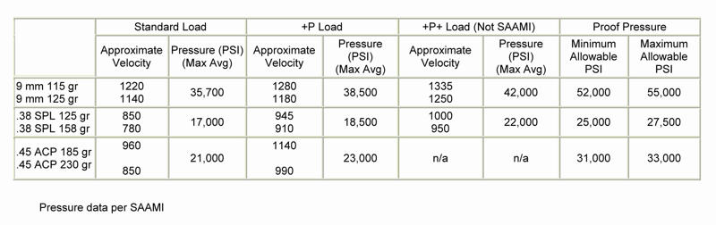

+P rated ammunition was originally intended, and I believe still is for law enforcement. To get a little extra punch out of there firearms. Provided there guns could handle it. +P+ is very hot and is not even covered by a SAMMI rating. These loads are darn near proof loads, and one should be very careful if using them. The only time I'd use a +P+ in 38 Special for example would be in a 357 Magnum revolver. I believe +P+ pressure for a 38 Special is about 22 000 psi, and they proof at 25 000 psi. Someone correct me if I'm wrong on this one.
"...not even covered by a SAMMI rating..." SAAMI only has +P ratings for some cartridges. The .357 Mag and .40 S&W, for example, don't have a +P SAAMI rating.
+P ammo is hot factory loaded ammo. +P+ is hotter than +P factory ammo. It has nothing to do with the powder though. Just the ammo's pressures.

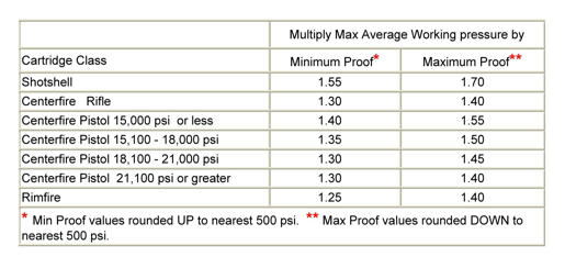

I have previously posted this before
Not many calibers have "official" SAAMI specs for +P loads.
Pressure for 40 S&W is 35,000 psi, with no +P spec.
