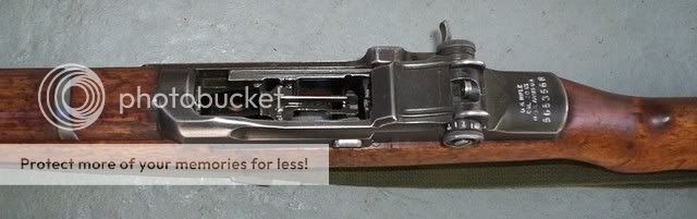

I bought the same..a H&R M1,....no rust or pitting...bore is very good,..all i did was buy a book "The M1 Garand..Owner's Guide"..by Scott Duff..lots of good info for the Garand owner..stripped it down..cleaned up the parts..and it didn't take much...apply the correct grease where the manual said to..washed the stock in Murphys Oil Soap..and then several coats of BLO.
Nice rifle..and oh...bought a surplus web sling

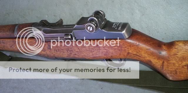

Stocks rubbed down with BLO on a scotchbrite pad.
Metal cleaned and oiled .
