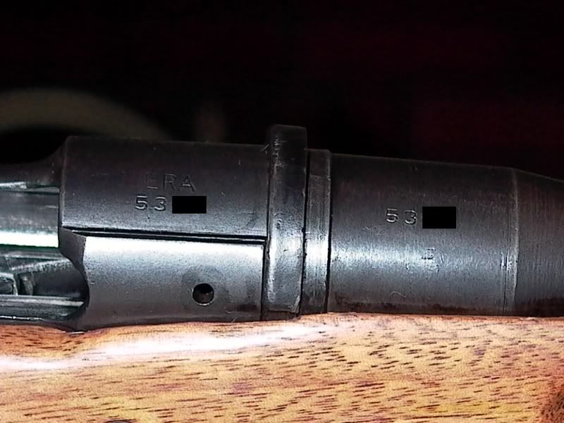

Today I picked up a P14 which is all complete except for a cut stock. Barrel and sights are original. It is serial numbered on the barrel, receiver ring and bolt handle...all matching. I wanted a shooter and the barrel on this one was better than any I had seen prior. It has many interesting marks which I was hoping would be covered here. Many parts have an "E" stamped so I expect it's Eddystone. Broad arrow and crossed swords and a large ERA....also a star or flower like symbol on the receiver. One very small stamped name on rifle receiver and barrel which looks like "NOTEN******". Pic attached. Another toy. Now looking for a full military stock....unlikely, I know...or a full wood rifle with a sewer pipe bore. Not much $$$ paid so really nothing to lose. Dave

When did ERA start production? I have a 4 digit 1916 dated ERA with bolt,barrel, and receiver s/n.

My source doesn't give an exact month of production, but Eddystone produced 604,941 Pattern 14 rifles from 1916-1917. Your rifle appears to be marked just "ERA" and the serial number...? (Eddystone Remington Arms).

Danforth - I have seen this stamp on several firearms sold in the UK but not made there - it says NOT ENGLISH MAKE. Usually this is on military firearms, since they often didn't have a manufacturer marked them anywhere.
