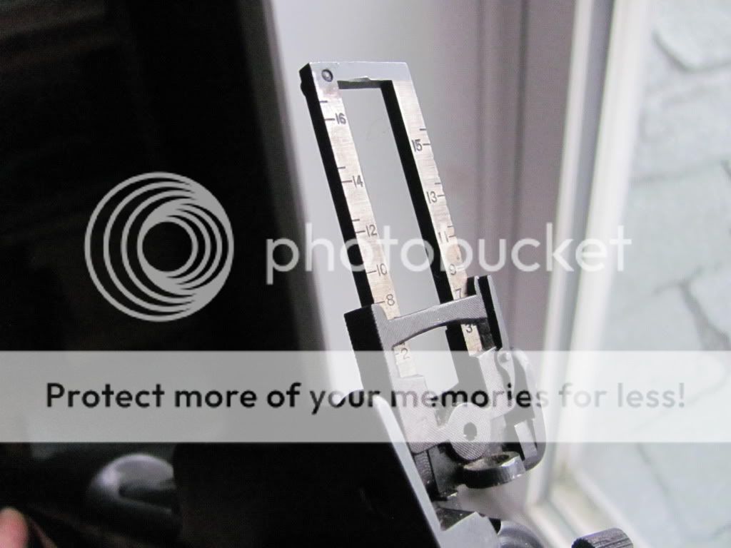

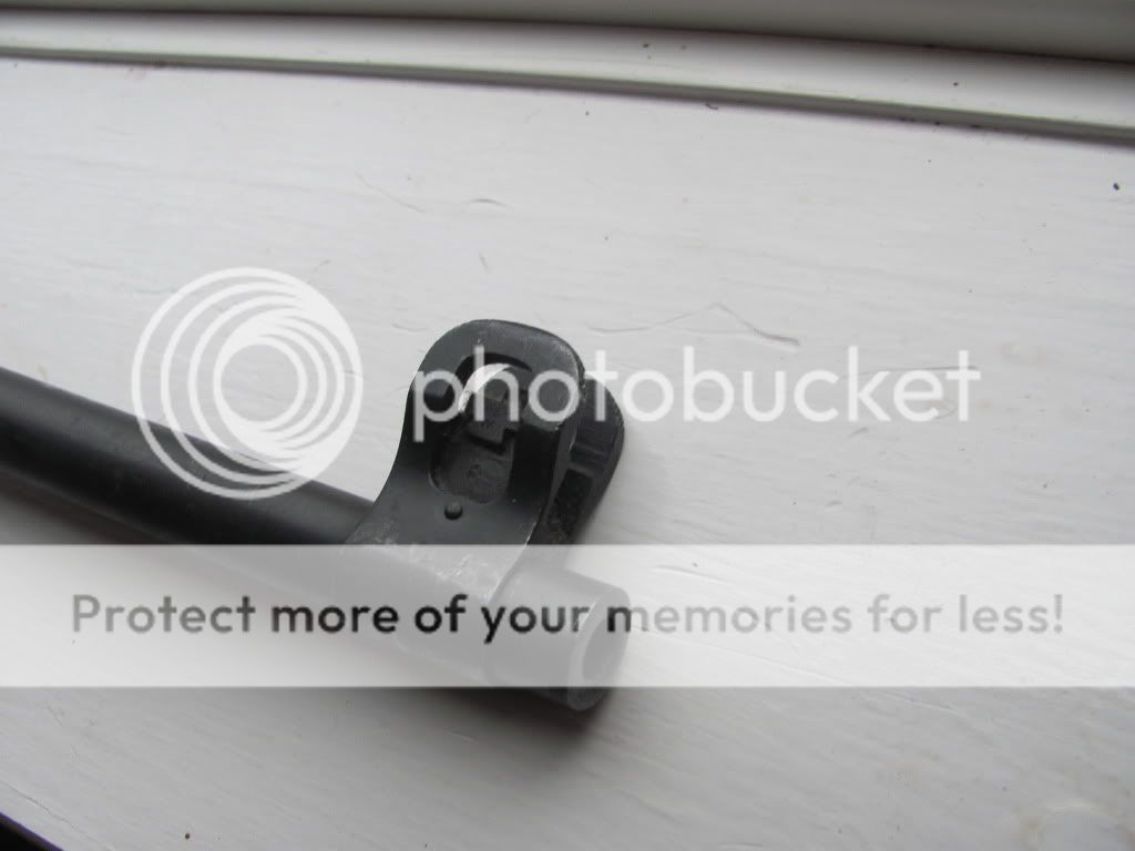

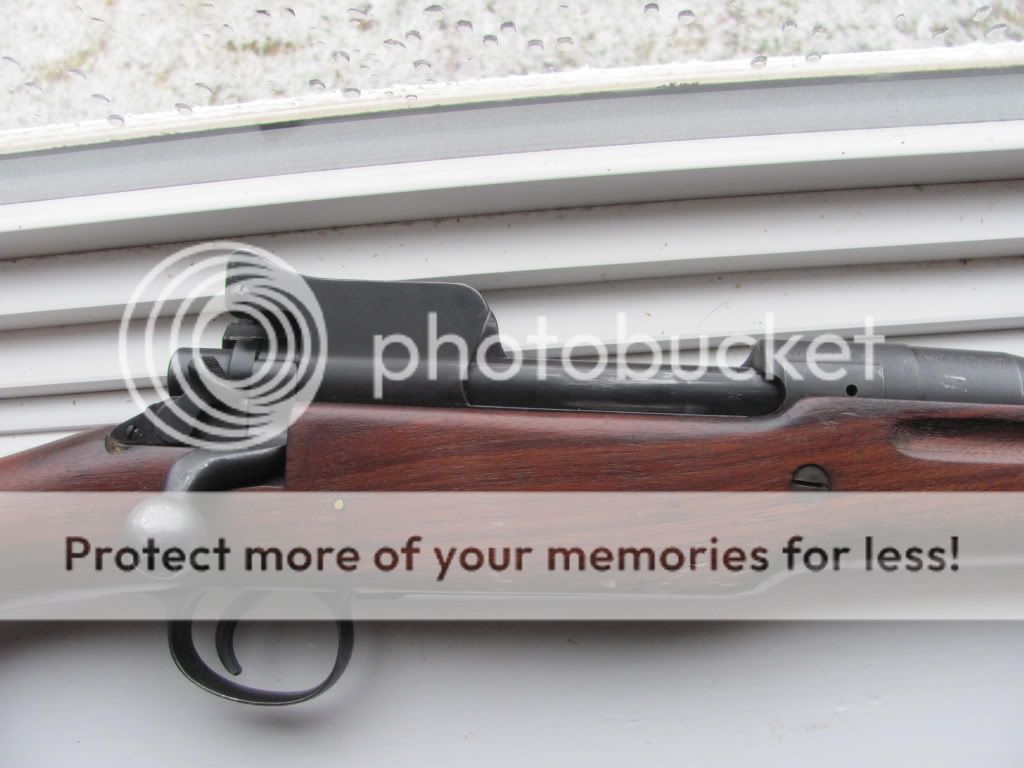

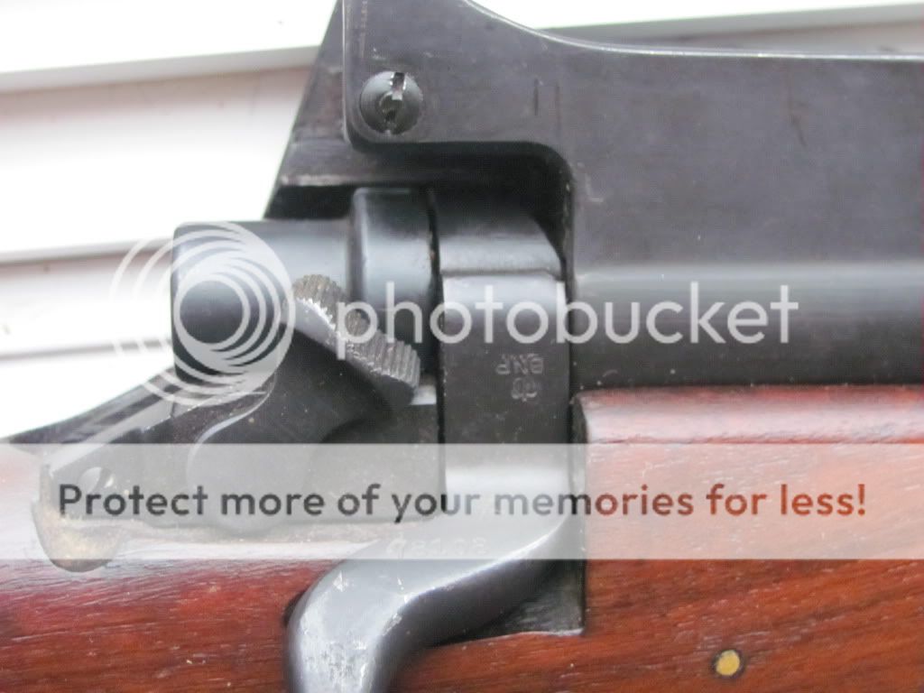

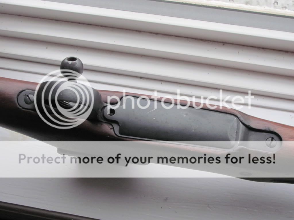

This rifle was recently posted on here requesting a value. I did a little reading and then it was sold to me. It's in really nice shape and the bore looks very good. I'll shoot it and if it's a shooter I'll start looking for a full stock set for it. :eek:
I like these rifles. This one probably hasn't got much historical significance and it's mismatched but I think it'll look nice restored and it's just neat.
Any one with knowledge or advice on using and restoring these rifles, please feel free to chime in. I just got it and would love to learn from some guys who know. Research isn't the easiest at the moment with 2 toddlers at my ankles as we speak.
I have one specific question; since it's a mismatched bolt, can I get a go/no-go gauge that will work on this as well as my No.5?
I just got done giving it a quick cleaning/oiling and looking over. It had some grime on it and it cleaned up nice!
I figure it's a Winchester by the W's stamped all over it. The bolt has two sets of numbers on it, none of which match the serial. :( Oh well. The bolt face is clean and smooth and the bore is shiny with nice looking rifling.

I wonder if that's why the finish is so nice on mine. It's got british proof marks all over it and it's in really nice shape. Would a rifle be marked to show that it was fixed up during that Weadon refurb?
Does the stock have a wooden plug where a brass unit marking disc would normaly be? If so that is a Weedon upgrade also a stock without the cut at all could be a Weedon replacement, but there also would be no provision for volley sights on the new stocks. That would make it technicallly a Mark II rifle. On some (actually most) rifles there was a minor modification to the bolt during the upgrade; the receiver should have a " * " on it and the bolt should have all or part of the serial number electro penciled on it. The Weedon upgrade was not totally uniform as the goal was to produce as many servicable rifles as possible as soon as possible. One neat thing about the Weedon Rifles Members of the British Home Guard had been issued them when Churchill made his "We will fight them on the Beaches" speech.
Cool! Mine has the wooden plug in-fill like you say and also no provision for the volley sights.
When I get home tonight I'll check to see if I can find a "*" on the receiver.
