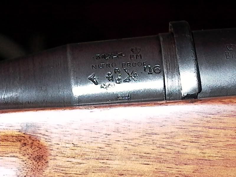

I'm up for anything here. I do know my P14 was made sometime in 1917 according to the barrel date but I would love to know roughly when too.

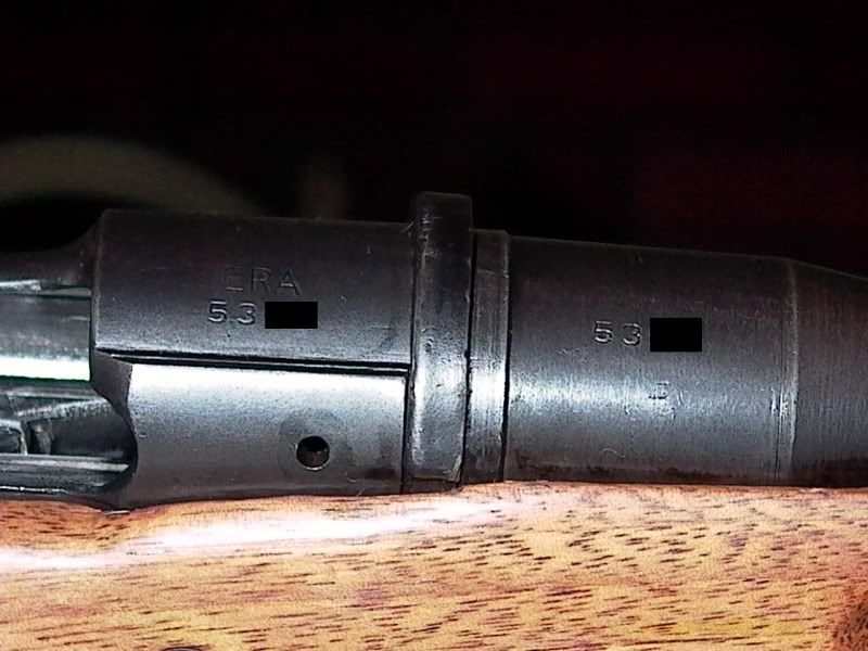

Mine is an ERA serial number range 51 ###. It seem like the best I can say is it was made during World War 1. The strange this is that is does not have all the markings that my Remington P14 has.
I have a 4 digit ERA....
